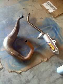

iv always hate to see a good after market pipe look like crap i bought this fmf off DUDE here on the forum for a great price thanks buddy i got to looking at it wondering if i could get it to shine like it did when FMF make it

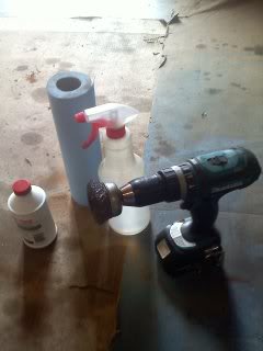

here are the tools i used for this little project
first i used the rubbing alcohol to clean it up a bit

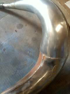

then i used the drill with the little wire brush it takes some time but well worth it
half way

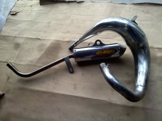

then once after all the junk is knocked off clean it again with the alcohol and use some kinda polish on it i went over mine about 3 times cleaning wise and polish
heres after i was done its nothing big but if your like me and cant afford a new pipe this works well
Reactions: Antec1200X
if you really want it to shine, get a buffing/polishing wheel and use it. it will make it look even better.
looks good
i used 0000 steel wool with rubbing compound on mine, then used mothers mag polish, then mothers again with a terry towel, wiping it down with a microfiber cloth.
that wire brush scares the heck out of me! wouldn't it be much less agressive to use a green scrubby and some elbow grease to keep from scratching the finish?? just asking?
depending on the rustiness of the pipe, you can use a soft wire wheel to clean it off, for bad rust use a stiff wire wheel then use a soft one. then you sand it down then use a buffer/polishing wheel to make it shine.
i used the wire brush on my kart pipes with no problems i wasnt to worryed about scuffing mine its scuffed and pitted pretty bad on a new one i wouldnt use it
