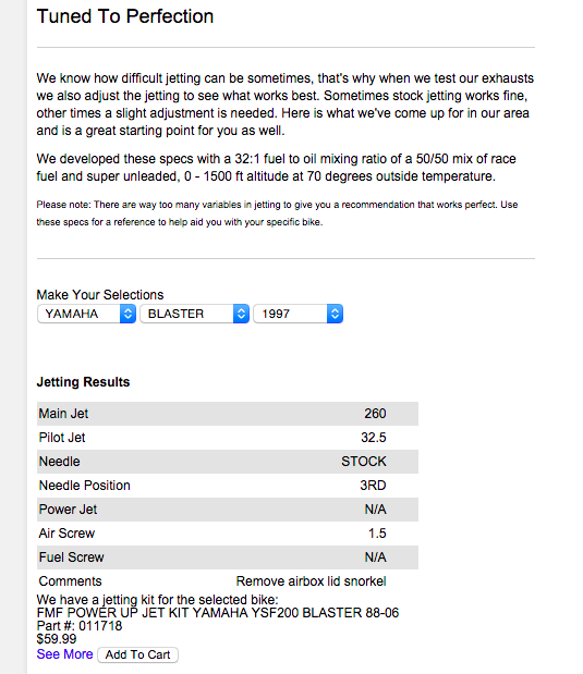

FMF exhaust and silencer
BR9ES
No compression test
Air screw 1.5 turns out
Premix now but only emptied out oil premix tank (no kit installed to block)

BR8ES....THE BR9ES IS A COLDER PLUG
and that pipe requires like a 280main jet around there/there is a lot of variables in jetting:)

Sorry, I am running a BR8ES as called for in owners manual and also have a 280 main jet installed as well. Not sure what you mean by the little metal plunger thing? Where is that located?
Bear in mind that any changes in the air flow, temperature, elevation, humidity, and oil ratio, may need different jet requirements confirmed by a plug chop.
