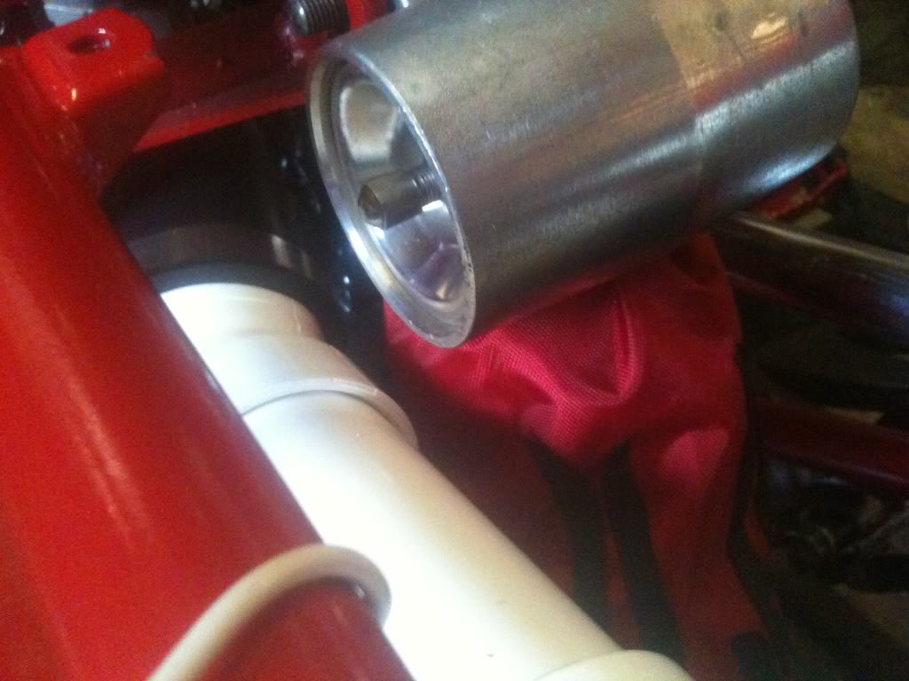

If I have to, I'll mold a piece of strait pipe to work. I may go that way. I can borrow a PVC heat blanket from a friend of mine.
yeah, heating and bending straight pvc was in my head when i was gonna attempt this, you can block off both ends with a rag, or duct tape, and slowly heat with a torch, mark off lines on the floor for the offset you need, once heated, lay on your marks and cool with a wet rag
This is my air intake setup I'm working on. I'm not sure if I'm going to run it at that angle. I'm going to trying and work with the other pipe to see if I can get it to set strait in the frame. I'll have to build what's going to be more of a shield then an air box.
cool idea with the PVC man, just make a sheild for the bottom of the filter and run it!
your going to get way more air that way
i made something like that with pvc on my blaster. except i didnt use fittings. i heated the pipe and bent it. it restricted the airflow

Another reason I wanted to use couplings is because I'm going to paint it. I'm going to smooth out everything and paint the pipe Black with the ends of the couplings done in red so it looks like red band clamps.
