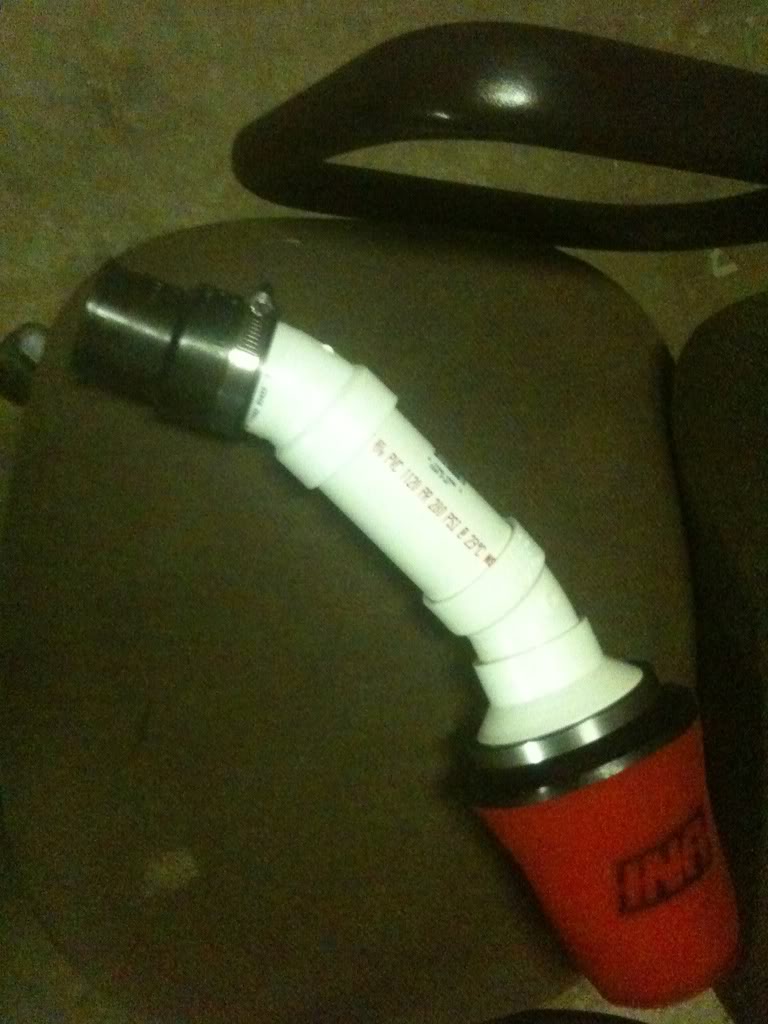

and heres what i and alot of us do for the pipe to carb connection............
Intake Pipe Reducer
fernco fttings from lowes or depot work too, but don't come in as many sizes as these silocons
This is my setup. The filter has a 3" inlet. At the filter, I used a 3x2 adapter . Pipe and connecters are 2" PVC . The part for the carb is a 2"x 1.5 rubber adapter. I think the bends are listed as 22 degree . I'm running an OKO 30mm carb and it fits great.
