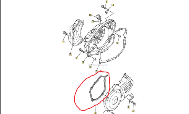

I've got white smoke coming from my blaster and by reading in the forum found it is most likely the crank seals. However I cant find the seals on any of the parts sites. Anybody got a part number or something. I was trying to find it on the Rock Mountain OEM parts finder. Couldn't find it.
Is this what I need? (circled in red) Rocky Mountain OEM parts finder says Crank Seal. I'm just double checking.
not in any way what you need.
look at the diagram for the crank, you need the "pto" side crank seal.

thats weird link works for me.....but its under crankshaft-piston number 16
