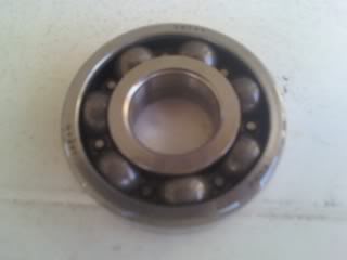

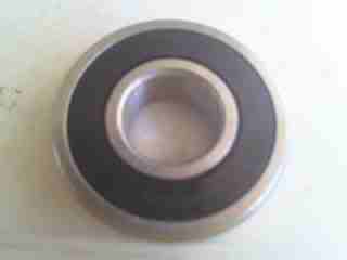

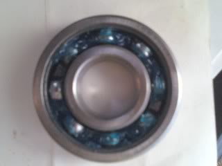

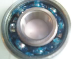

The part number is 63052r which is the same number as the original ones from factory just different company. Here is some pics of the new one and a pic of the old one
With shild or seal what ever it is on.
With out it on
Ferther back shot of it
This is the factory one
Looks like a better bearing than the stock one, it has one extra ball, that must count for something.
Less pressure, less friction and more support.
The stock one may have less balls, and larger spacing for eaiser pick up of oil.
If you do use the new one, completly remove the grease and lubricate with the 2 stroke oil of your choice.
