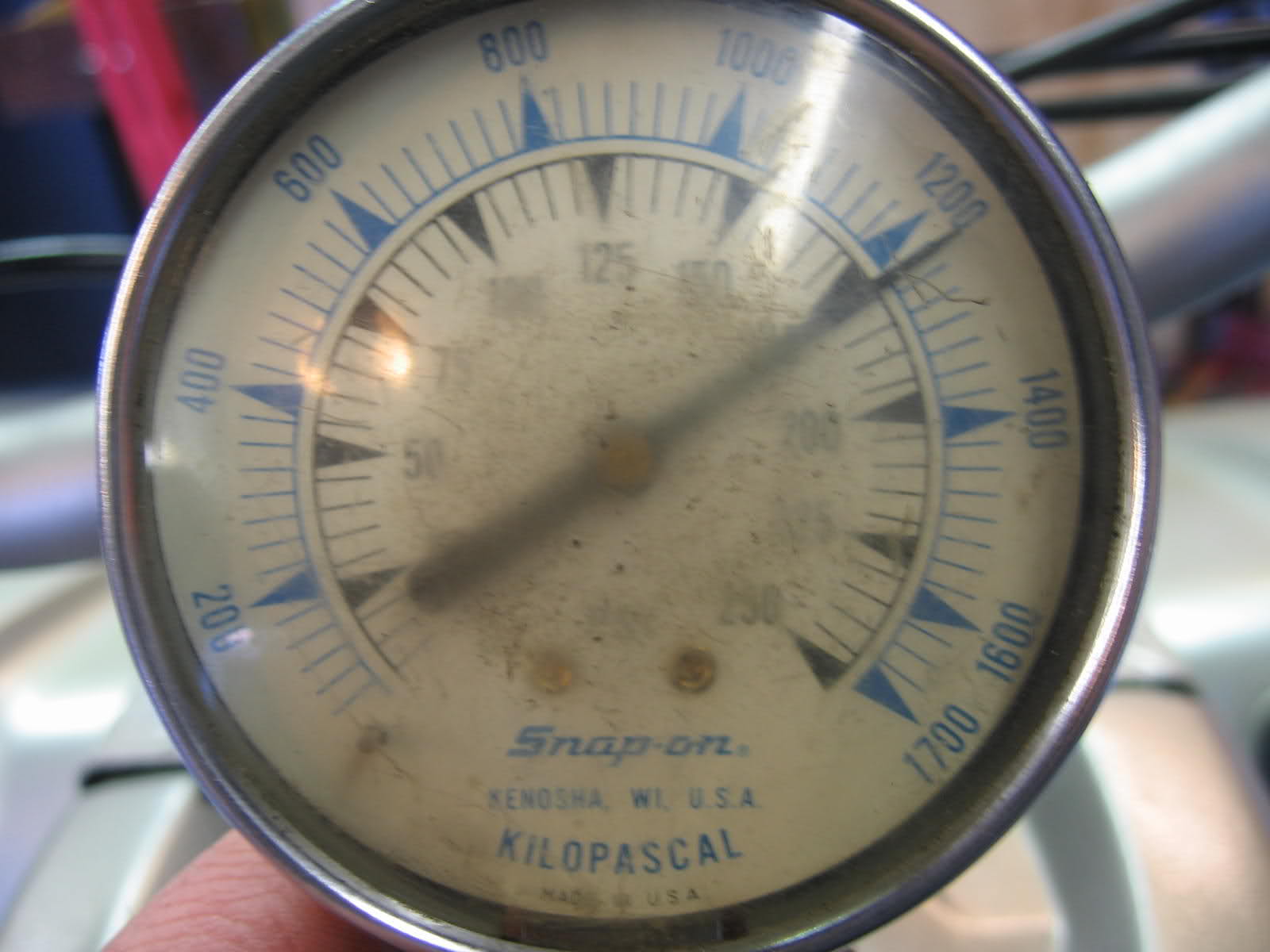

so, when doing a compression test on the blaster. how many times do you kick it over to read your compression? after 7 mine reads 145 but after 10 it reads 175 on a good snap-on gauge. what do you all test at?I:I

that is kinda strange....i always thought they should max out after like 3 kicks. I dont really see how it can keep building compression. Are you doing it on a cold cylinder? holding the throttle wide open?
i think there is your problem...your tryin to suck enough air to fill your cylinder all the way with the throttle barely cracked...retest it with the throttle wide open and i bet you hit 170 within 3-4 kicks
ok heres what i got....... 178 psi. compression gauge cover is a little worn, gets a lot of use.
