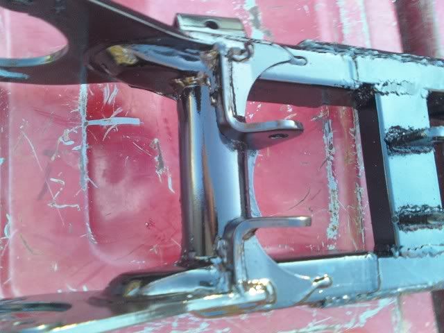

ok here is a couple of pics to compare my old ebay swingarm and my new swingarm I had yb200 fab up just from the looks of it and this is my opinion but im thinking the yb200 build has it won hands down....lol but heres the pics

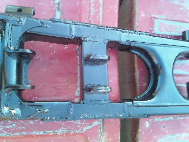

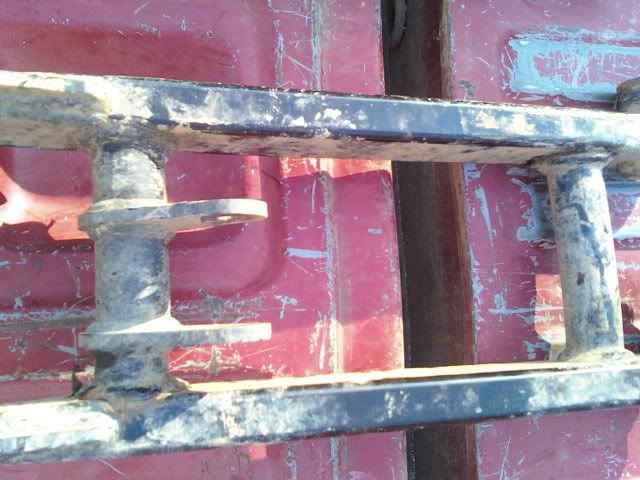

ok now this is the comparison of the twos top crossmembers
yb's
http://i223.photobucket.com/albums/dd15/nonpoint86/002.jpg
swingarm shop
http://i223.photobucket.com/albums/dd15/nonpoint86/003.jpg

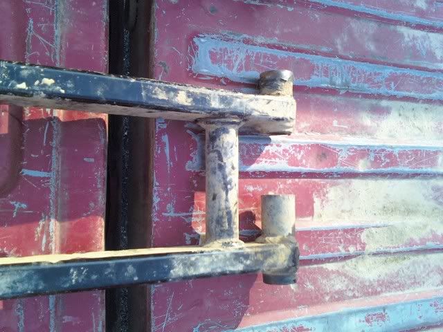

alright now here is the center section notice with yb's build you get the xtra middle crossmember and with the swingarm shops you do not
http://i223.photobucket.com/albums/dd15/nonpoint86/004.jpg
http://i223.photobucket.com/albums/dd15/nonpoint86/005.jpg

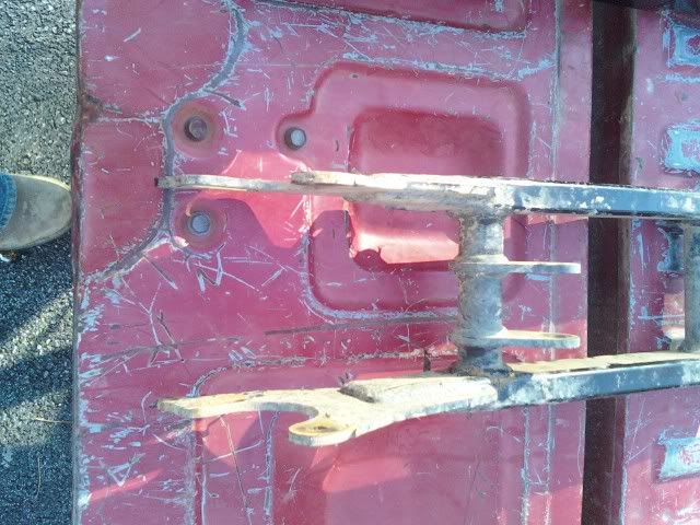

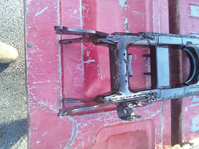

ok know for the rear of the swingarm there is a couple of things I favored here i like how ybs is more beefed up and more towards the rear of the swinger unlike the ebay one and yb's it has way more thickness to it heres the pics
yb's
http://i223.photobucket.com/albums/dd15/nonpoint86/008.jpg
http://i223.photobucket.com/albums/dd15/nonpoint86/007.jpg
swingarm shops
http://i223.photobucket.com/albums/dd15/nonpoint86/009.jpg
just wanted to show everybody the diffrance and if you are to buy a new swinger i really would recomend in hitting up yb200 on here dude does some really good work and is an awsome guy to deal with alli can say is this swinger is the sh*t...lol:D

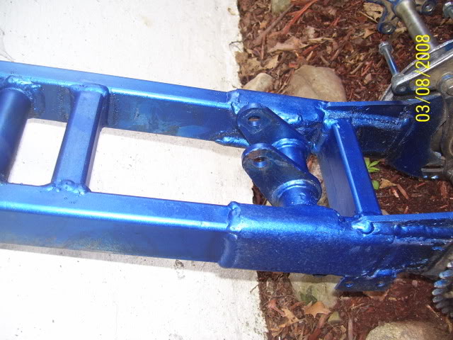

heres some pics of mine and what i did to it
i havent had a prob since i reinforced it
looks almost like mine...

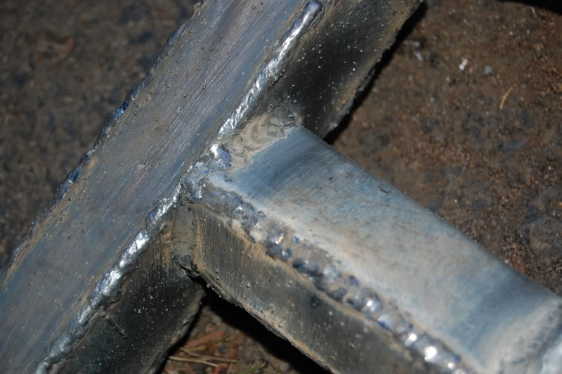

i would just be careful with those welds on the shock mount part.. they don't look like they penetrated very deep. but it looks very good other wise, im sure it much better then that eBay bull$hit
this is exactly what i've been waiting for, proof that these swingers suck, and will break, and if it can be broken, i will break it, luv me some big air, imagine that breakin on a hard double landing, good thing i waited
I deff agree with what Hatchhonda said about the welds on the shock mount. They don't look penetrated very deep. Next time if your welder doesnt seem to be penetrating very well leave about a 1/16th gap between your metals or bevel the edges. That should ensure that your welds will be strong.
Other than that it looks really good. I would deff feel better riding with one like that rather than a swing arm shop one. Good Job

if you set the heat range right the mig would penetrate, the pics of yb200 welds look a little bubble gummy
^ yep, gotta have enough heat. I prefer tig welding tho, nothing beats it for penetration or looks

looks good yb... maybe a little more time gringing and touch up welding andyou could have some mint lookin swingers.. deff looks stronger than the ebay one...
