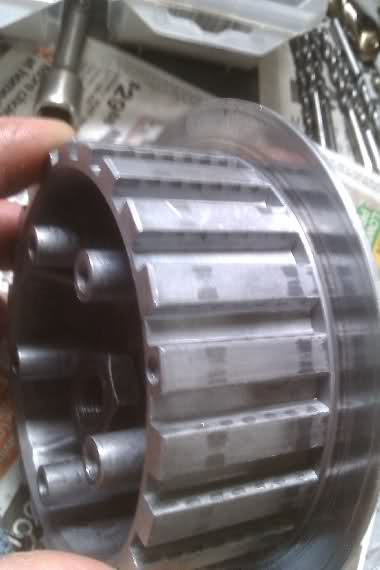

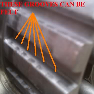

6. Look for deep grooves where the inside and outside part of the fibers and steel plates ride.
Compliments of AWK08-
Inner basket groove marks-
7.The outer basket look at the fingers on it that is where the grooves will be.
If you see deep ones or anypiece broken (I'd replace it), the outer basket fingers one you can file down but only go as far as you need to (until the grooves are flat again!) Remove the baskets before you try to file anything , you DO NOT want aluminum shavings/filings in your crankcase!

Great write up only now I wish I had my super sweet KX125 back instead of my blaster though. It had the exact same problem only the outter hub had 1 of the 4 prongs snapped about a 1/4 inch off and had deep grooved teeth marks in the inner hub though. But the thing is All I had to do is have the bike moving and I coud drop the clutch and take off but if I would stop It would jerk forward and sputter out even though I had my clutch in and in gear. I dont mean to thread jack but for future reference can slickerthanyou or sicivicdude tell me why this was happening to me please.
Its just the wear That is to be expected. If you dump the clutch a lot it will greatly accelerate this wear as well.
I'd say 7 out of every 10 clutch baskets have grooves in them. I've had 4 of them and only one was still in good shape.
The other thing that you will notice if you're rough with your clutch hand is it'll wear out the rubber isolators in between the gear and basket and you'll end up with play there as well
