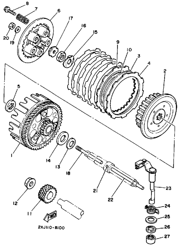

i have a 1989 blaster.. and there's a spring inside the clutch pack. where does it got... like what order..cording to this blow up it looks like it goes clutch plate then friction plate then
another clutch plate with the spring in the middle. if anyone could help that would be great
thats right. from the very back it goes normal friction plate, metal plate, friction plate with the spring inside it then metal then keep alternating. last should be a friction plate if you did it right, not a metal.
i got the quad used.. so i didn't know what the person before me did.. b.c that spring is on the first one. i didnt know if that was correct.can i just remove it are replace that friction plate with a normal one i have from an old,but still good clutch??
you also have to watch it cus if u still have a stock clutch pack there is 1 friction plate that is smaller than the outhers becouse of that lil spring plate thing if u have a manual it will tell u the exact order of how it goes
