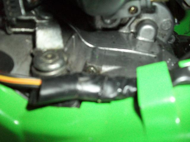

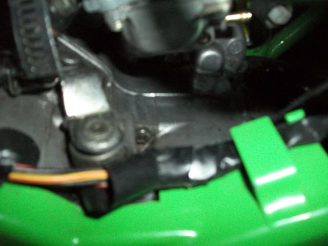

Now mine is not exactlly lined up, pic taken in the dark and the rain 4 ya. lol

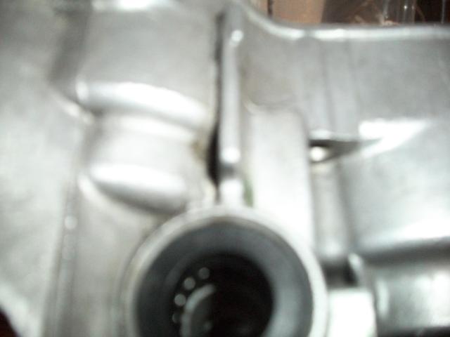

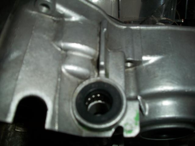

I have a spare left case, so here is pictures.

Alright so i align the notch on the left side cas where the clutch shaft thing is with the pic that u have of a dot and line? I am attatching a pic of what i think your talking about. and i appreciate the help and rainy pics!

Mine does not line up, cuz when I did mine,I didnt have my clutch cable on. and when I did install mine, it pulled it forward. like you see. but it works fine.
If you get it close,you shoul be okay, if you cant get it right on.

So far it seems like it pulls in best when the screw is turned all the way in. The notch is at a 90 degree angle to the shaft
I mean im just not totally sure what your talking about. It is the little arrow on the shaft am i correct?
