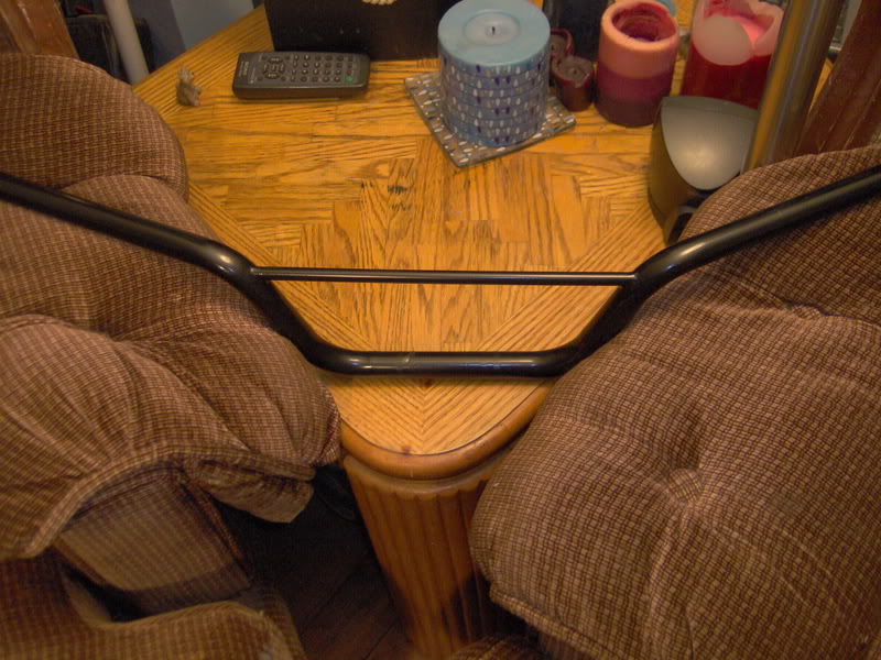

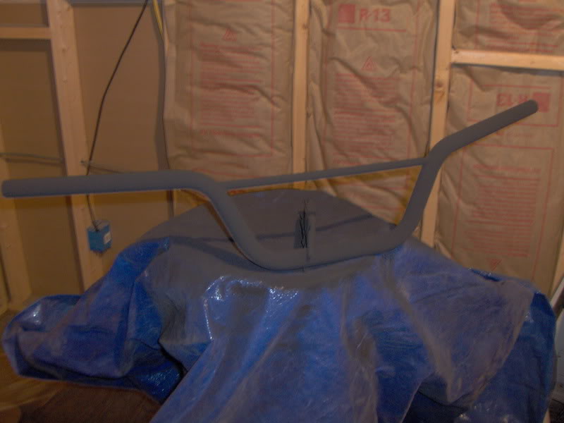

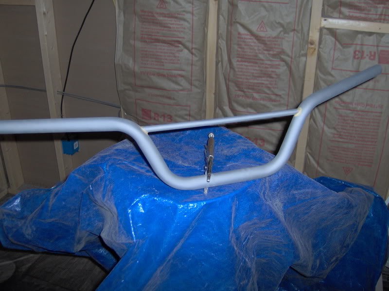

here's some shots of my bars goin through the process.
Sandblasted and wiped down with a wax/grease/oil remover
Shot and all powdered up
Cooked in my oven for 20 minutes and done!
I get my chrome powder from Columbia Coatings and they also need a top coat such as a candy, or a clear.
They make a very bright clear coat which protects the chrome base, and "brings out the shine".
