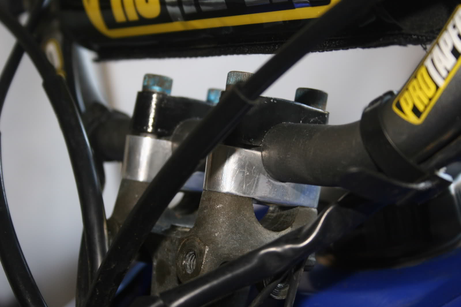

B Blasterdude27 New Member Nov 19, 2008 7,592 63 0 Just outside of fairbanks ak Jul 23, 2009 #22 Nice! I've got a set of mojave claps laying around, time to go try it! rep +1
B Blasterdude27 New Member Nov 19, 2008 7,592 63 0 Just outside of fairbanks ak Jul 23, 2009 #23 Your a good guy freek! the extra leverage is great. I've even got another set of clamps off a kx, once I get some longer bolts I'll make a double stacker

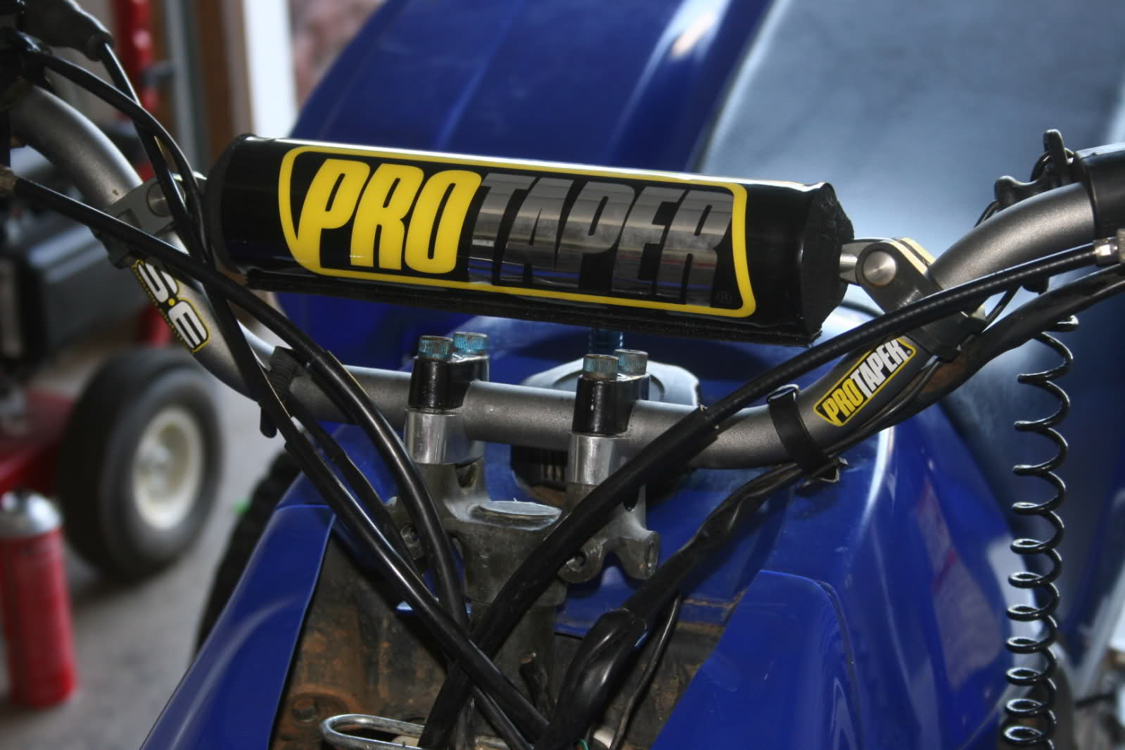

blasterfreek30 Member Jan 27, 2008 9,634 129 94 north nj Jul 23, 2009 #24 thanx bro, yea its works great, ive get an extra set if anybody needs them

blasterfreek30 Member Jan 27, 2008 9,634 129 94 north nj Aug 2, 2009 #27 thanx bud, just like it says quick and easy

blasterfreek30 Member Jan 27, 2008 9,634 129 94 north nj Aug 2, 2009 #29 longer blots and a extra set of handlebar clamps and it raises it almost an inch
blaster01 New Member Jan 17, 2009 3,575 37 0 Virginia Aug 2, 2009 #31 i did it except i used polished honda 250r clamps(thats all we had laying around)

kylepotatoes New Member Aug 27, 2008 350 8 0 Little Britain, Ontario, Canada Aug 18, 2009 #39 Just did this today and what an improvement! I took the clamps and bolts off a Yamaha Bravo and got about a 3/4" of rise.
