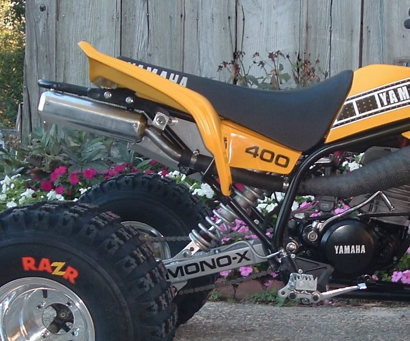

could someone give me detailed pics of the cfm installed from the kicker side of the quad ?I got cfm airbox & shrouds for $120 just made them an offer!!!
Here you go man hope this helps. Although hard to see it bolts in on a spacer at the corner of the frame. You can see the mounting point right in front of where my old silencer is bolted up.
