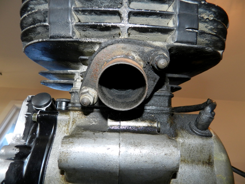

Hey guys new to the forum and also new to blasters just picked one up with a blown top end I was tearing it down today and was wondering is there any trick to getting the exhaust off of the studs? It's an fmf exhaust it just doesn't have much room to get out it also does have skid plates ...also the carb slide is very badly scored any ideas on why?

Remove the silencer 1st. Then remove the spring on the exhaust that connects to the engine. There is a bolt under the hood at top of the exhaust pipe you need to remove. You don't need to remove the exhaust flange that is held on with the studs. Also make sure you have your plastics all off as it will make it easy.
Oh wow so it comes out of the smaller hole? Not the whole flange and all? Even on this fmf aftermarket pipe?
Sweet thanks I got it out ..but left off not getting the front 2 headbolts off as I had to head out for the day wil finish tomorow but got my top end ordered along with a carb rebuild kit as well
