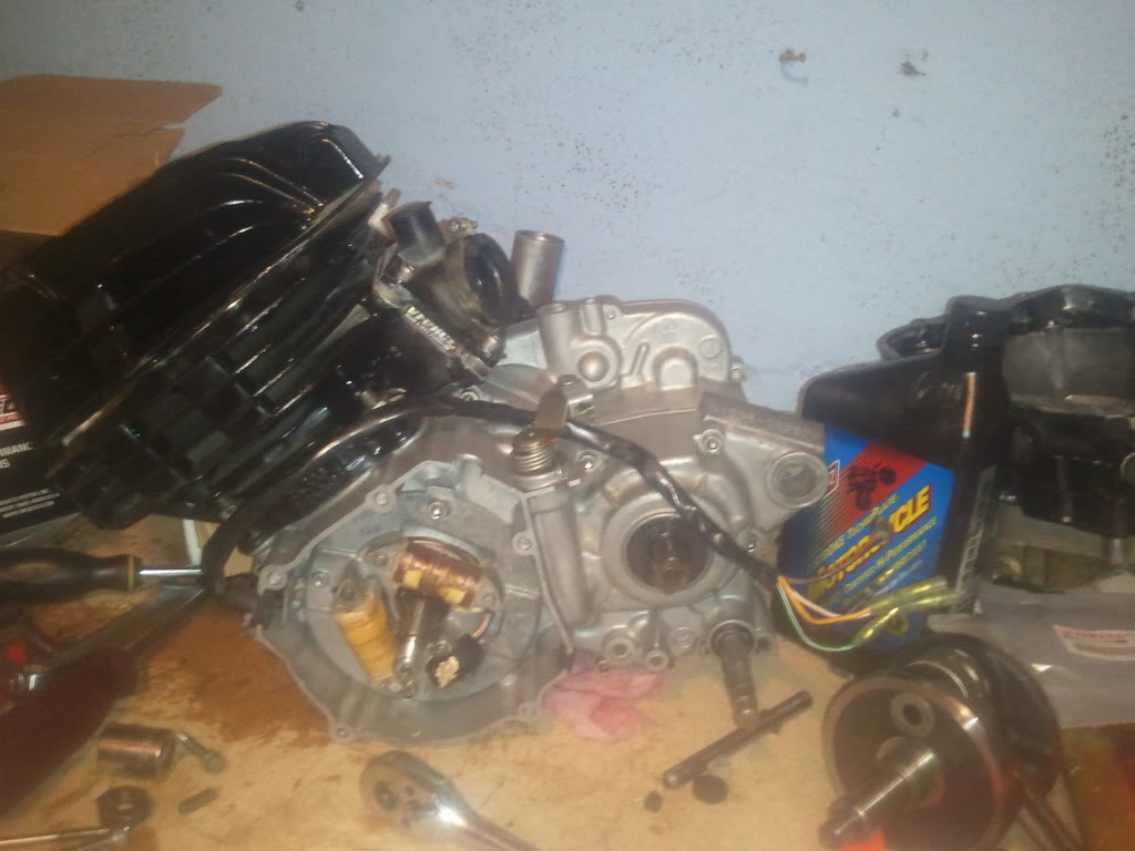

progress finally!!!! I think I have parts from 3 or 4 bottom ends in this thing, going to get the leakdown done yet tonight, and then If all is well, and pending decent weather, it goes in the blasty tomorrow
didn't get it in, had more thread repair to do.
got that fixed, just passed a leakdown. hopefully I'll get it in over the next couple days, I also need to get my rear brake caliper on before riding the new motor....front brakes don't work very well when they're off of the ground. and thy were already up quite a bit.
I'm just hoping I don't need to go to a longer swinger, that Laeger's is too sweet to ditch!
just another update, it got too cold/dark out by the time i've been getting off of work to make much progress. the motor is pretty well ready to throw in. I just need a couple hours of decent weather/light to get this stuff done.
