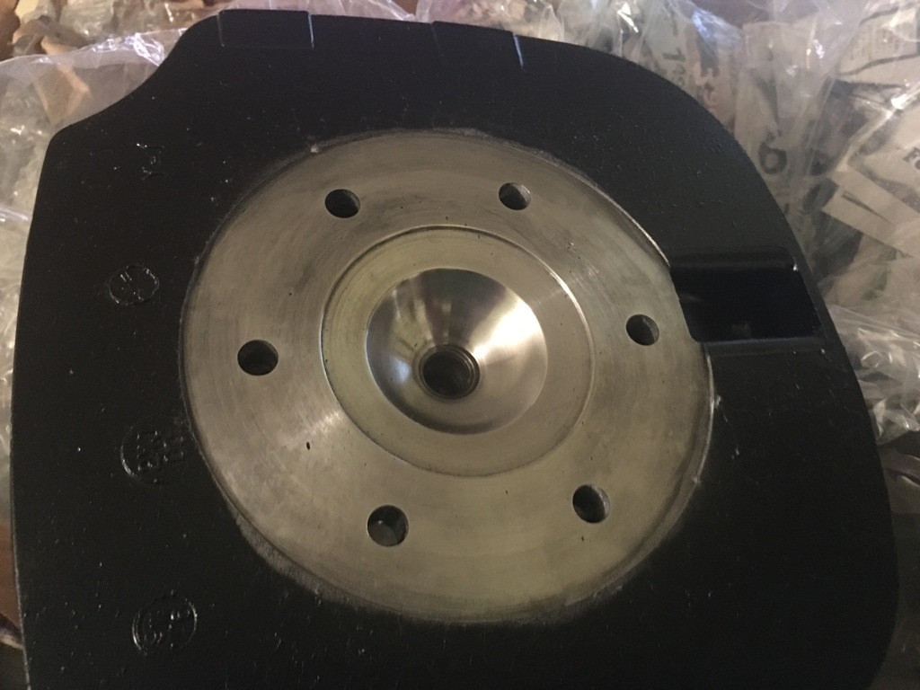

Consider getting it modified rather than just milling. Improved combustion chamber will add more ponies , far less likely to have detonation.
oh ok...so wht you have in mind as far as doing my head then
1. Find a nice box that your cylinder head fits into nicely, and some cushion!
2. Call Ken and tell him you want to get his head mod
3. Send Ken your cylinder head
4. Receive cylinder head from Ken
5. Stare at the beauty of this man craftsmanship, maybe take it out on a nice date, whatever floats your boat.
5. Install and be amazed lol.
This is mine after getting it back from Ken. Its not only shaved but completely reconfigured. Its worth every penny.

Compare what your stock head looks like to the pics jbuckster posted. Notice stock is a conical combustion chamber, modified is a hemispherical dome. It was one of many things Yamaha did to DEtune the Blaster. I don't exactly recall the effects but would speculate that it slows the flame front/combustion process , and thus power output.
If you have access to a lathe, joeAK47 has a video on YouTube that shows how to cut your own head.
Maybe someone else will explain it better. I know that Joe and Best have done a bit of testing.
Hopefully someone will chime in with Butt Dyno numbers as to effectiveness of this mod.
FYI, even the Banshee improves with better dome design. Mostly because it's a late 80's design and a lot of R&D has gone into it.
Domes for coolheads are even custom cut for fuel type, desired compression ratio, even exact bore sizes.

You will need to build a arbor first. This will fit in the three jaw chuck of the lathe, and will have threads at the end that mimick a spark plugs threads. The head is then "spun" onto the arbor. It spins with the arbor when the lathe is turned on. You will need to take about .030-.060 (thousandsths), then go from there.
If you are running a stroker crank, you will need to cut the head for piston clearance due to the fact that the piston comes out of the cylinder.
