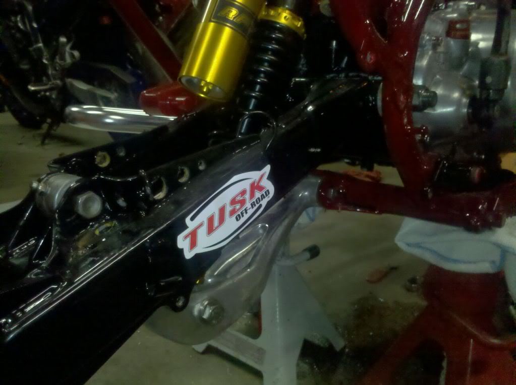

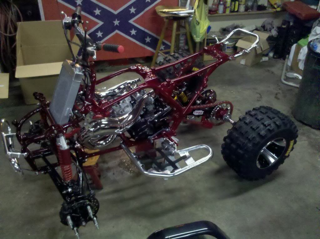

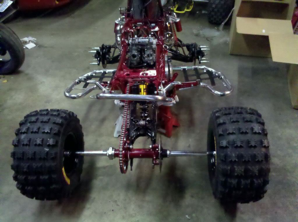

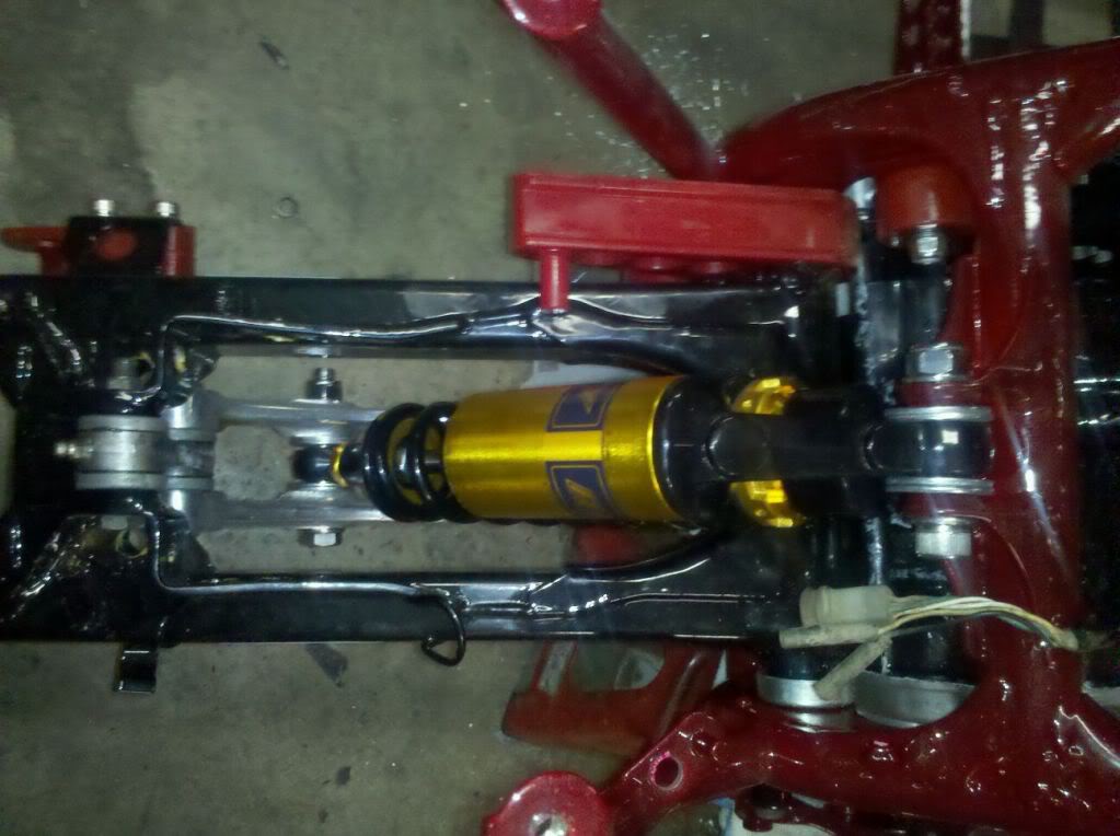

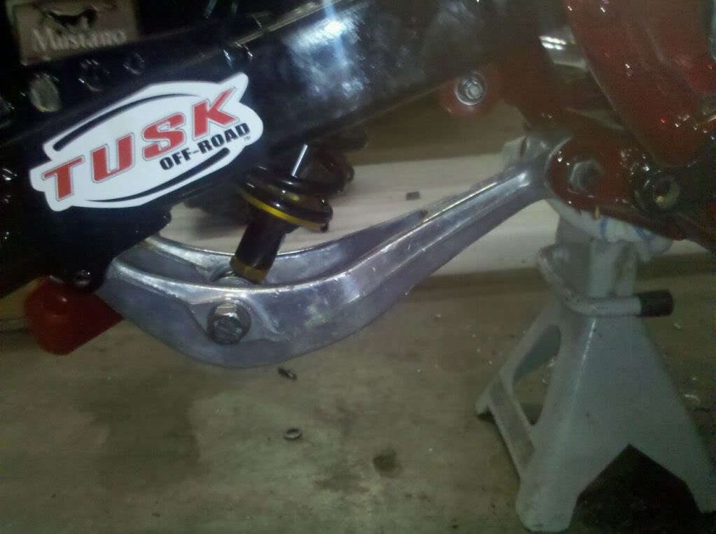

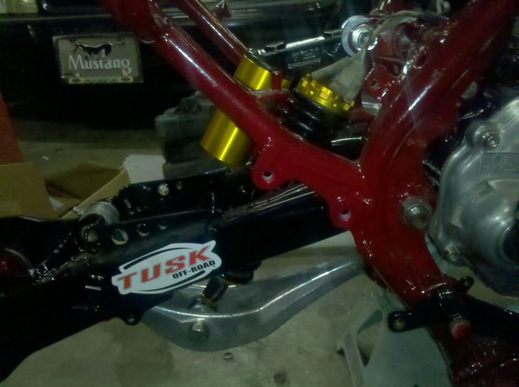

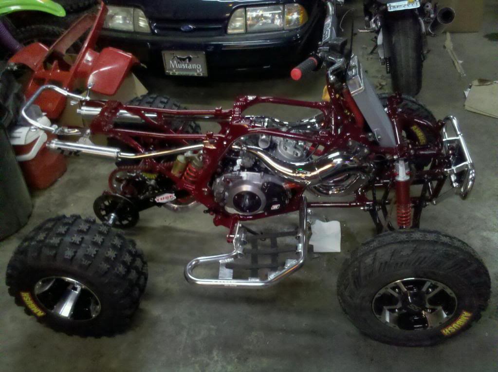

Finished the rear suspension tonight got a polished dog bone to finish off the bling bling as my little bro calls it.lol
Pics of the rear suspension...
The new SS112 wheels and ambush tires will be here tomorrow so i should have it sitting on its own tomorrow evening.After that i gotta fix the hack wiring job and paint the plastics.Gotta hit up harbor freight for a HVLP paint gun.

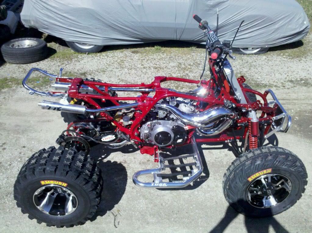

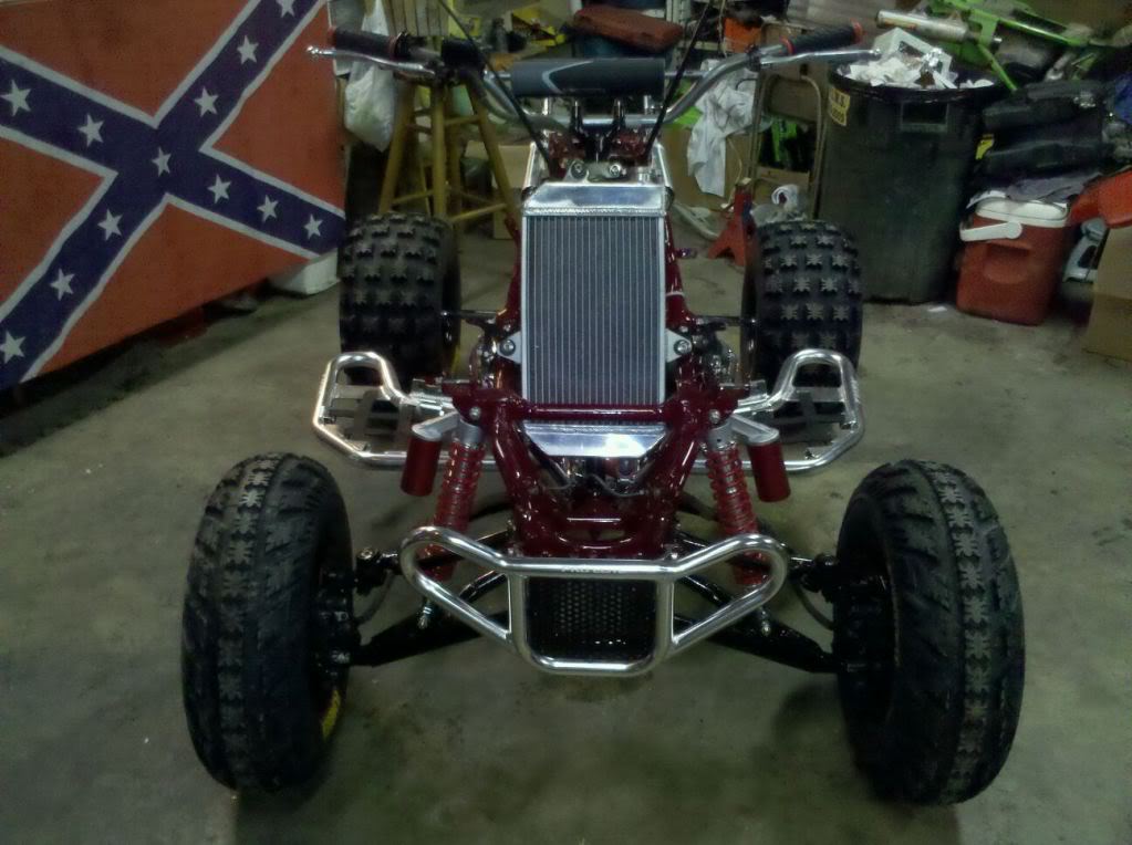

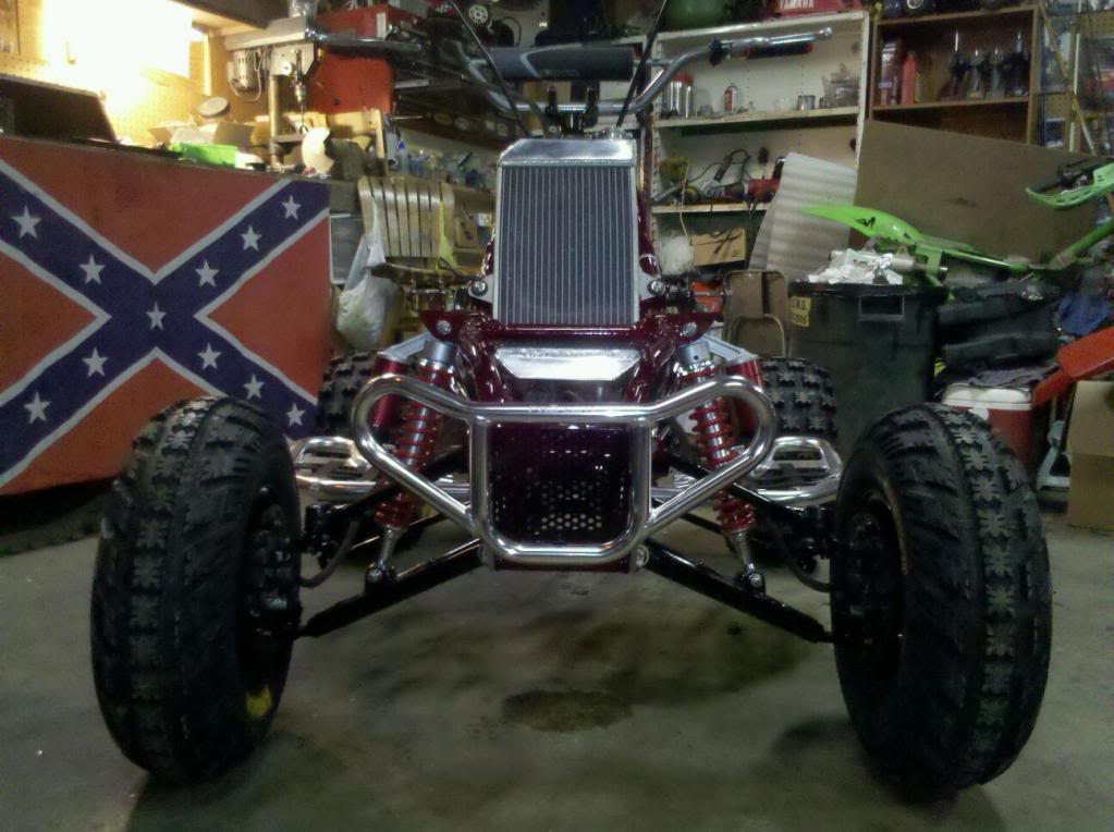

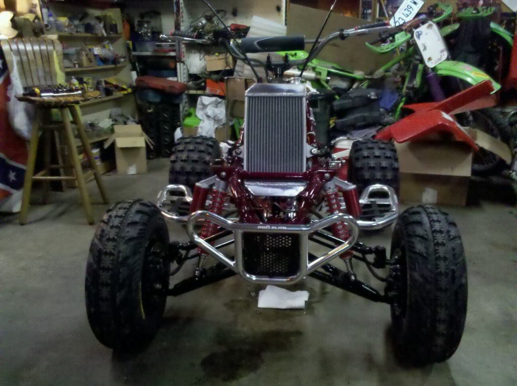

Just got the new SS112's and ambush tires on whatcha think???I love the way the SS112's look on this shee definately fits the look im going for.
Couple more Qs, just read whole thread. You said the cheap Ebay shocks. Those the ones for like $75, and are they the 15" ones? What is your rear shock? Definately need a ride report on the shocks. Did Ken just re-install the sleeves properly or did you have to get new sleeves? You said head was resurfaced, just lapped or actually milled if so how much?
Well the rear shock if you notice is gone and i put the stocker back on the ebay shock was too soft and bottomed out with my fat ass on it.
The fronts though feel real nice.havent rode yet but the fronts are definately descent for the price i may rockem for a little bit.

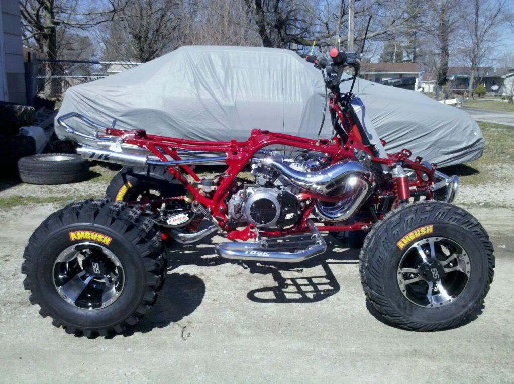

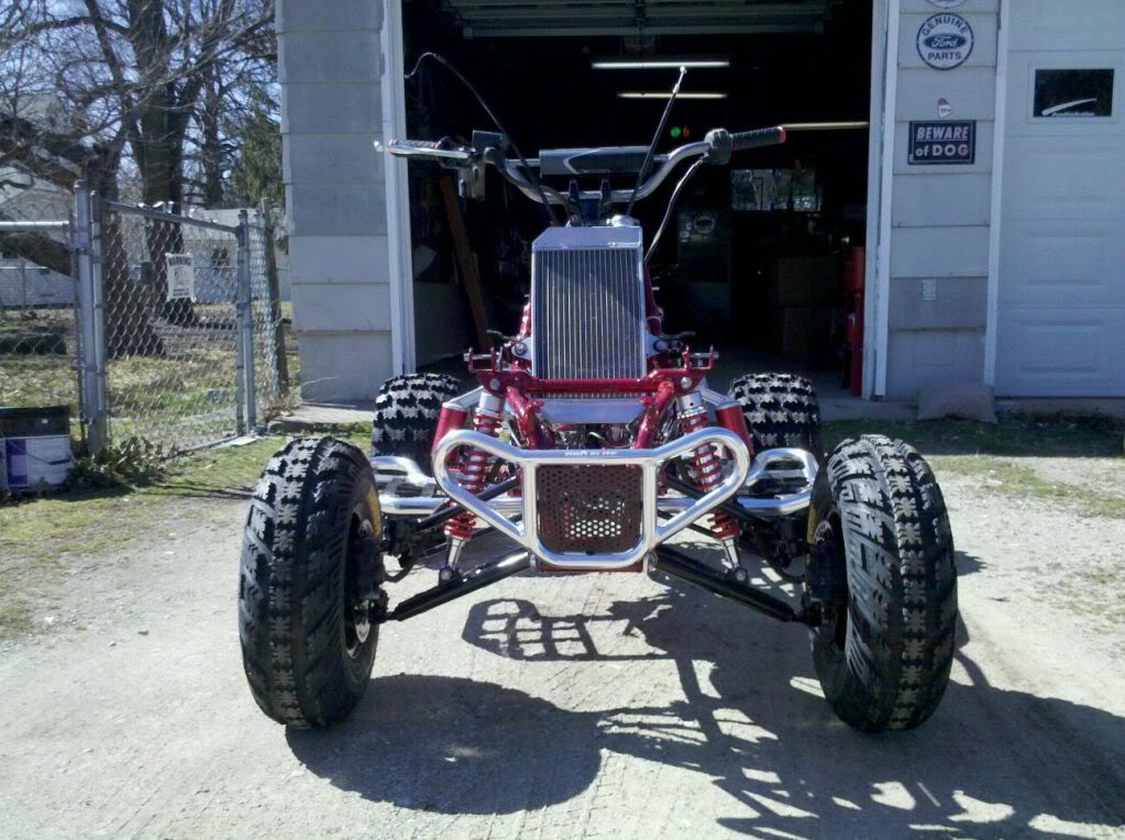

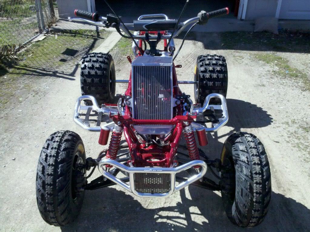

Had my little bros blaster in the garage today to tune the carb and swap reeds anyhoo pushed the shee out into the sun light and had to snap a couple pics of it.
I cant wait to get this thing up and ready to ride!!!!
SS112's and CST AMBUSH.
Front 21X7X10 REAR 20X10X9
Yea i hadnt seen it out in the actual day light yet but when i rolled it out my little bro was like damn that things shiny and bright!I wish my camera would pick up the flake like in person it looks so much better in person.

Your right carb looks out of level. Need to ditch the boost bottle.
Carbs arent even tightened down theyre just sitting in there.And whats wrong with the boost bottle?If nothing else it looks better than the factory balance tube.Until i find out it actually does harm ill probably rock it bro.I got the chariot performance reed cages that i read so much about on banshee hq i cant wait to try them out.You know much about them?They look solid!

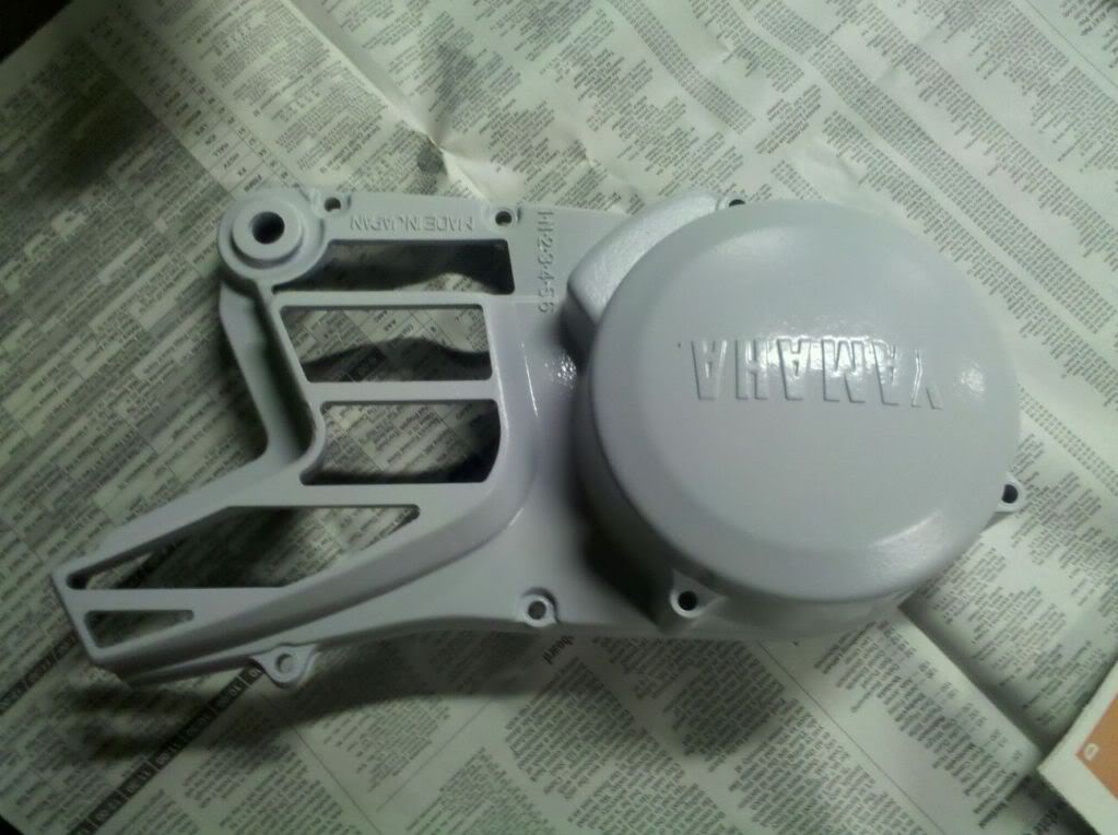

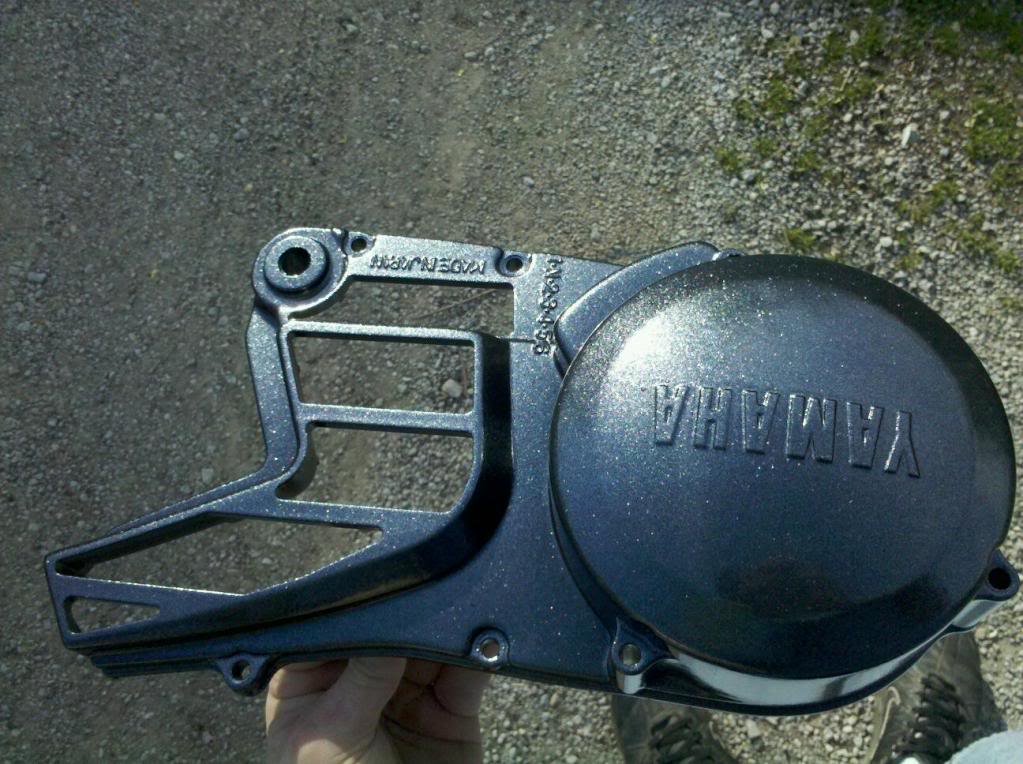

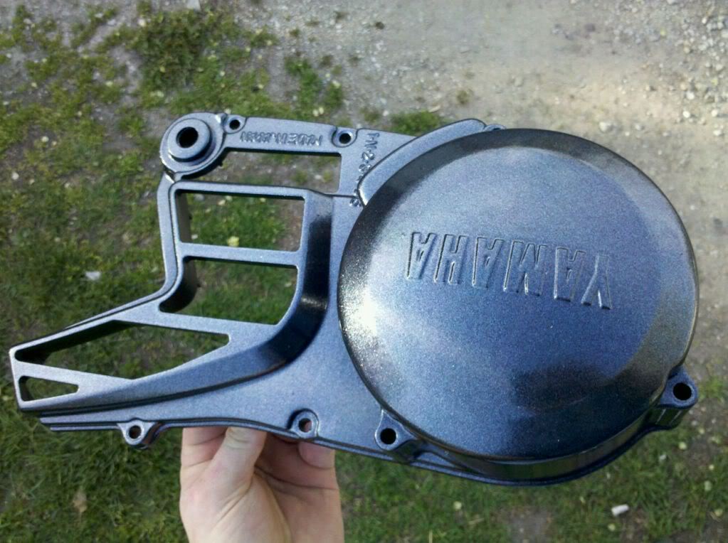

Did a couple small peices since its been a while since i painted.But i think they turned out well considering the last time i painted and for using duplicolor from the parts store.
BTW this is not a spray bomb its primer/base coat/clear coat auto paint.I dont belive in spray painting unless its an engine or a small part.
Started on the stator cover and hood heres the stator cover
