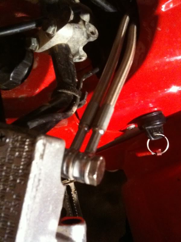

they are hydro...i just got streamline lines was wondering if they went straight to the m/c or did they use the spliter
If there long enough to go from wheel cylinder to master cylinder, you have a longer banjo bolt and 3 washers then they both go to the master. Remove your splitter, bolt up the new lines and bleed them. Here's a pic of how they look at the master.
