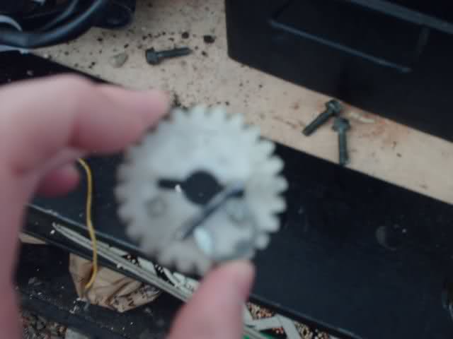

do you or anyone have a pic of this white gear i need to pull? or is it the only white one in there??? so basically just pull this and its done? or do i need to find hoses to car and put a screw in them or cap???
follow the hose from the oil pump to the carb and you need to block off that hole on the carb. i just found some screws that fit really tight a put them in the cut hose
the white gear is behind the clutch cover. you cant miss it.
You have to take off the Oil Injection Pump Cover and block off the intake and output nipples on the pump as well or you will leak oil.
