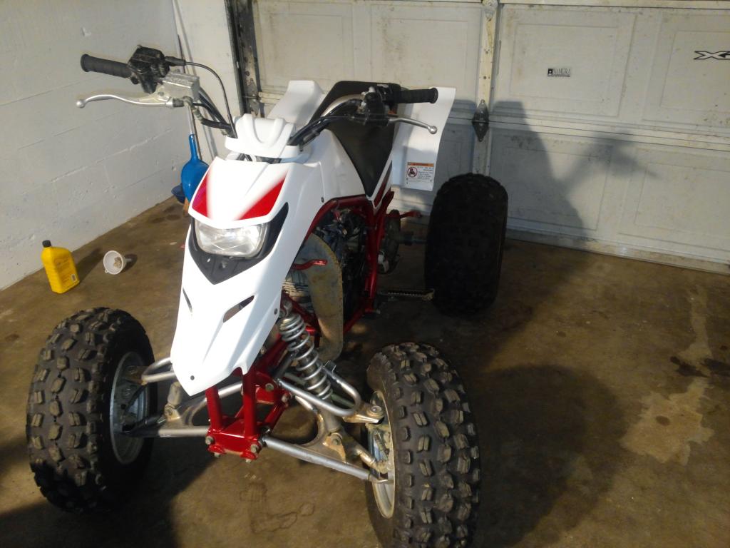

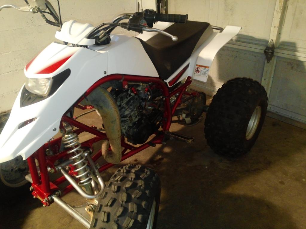

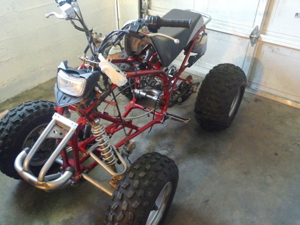

Need to top off the trans. Tighten a few bolts here and there. Give it a good once over. Taking it to the beach and ripping it for a bit, then flushing the trans one more time. Seems to run fine so far. PO told me it idled high when it warmed up. Or after an hour riding. So, I need to run it for a while and get it good and warm/hot. See if I have any air leaks I can find.

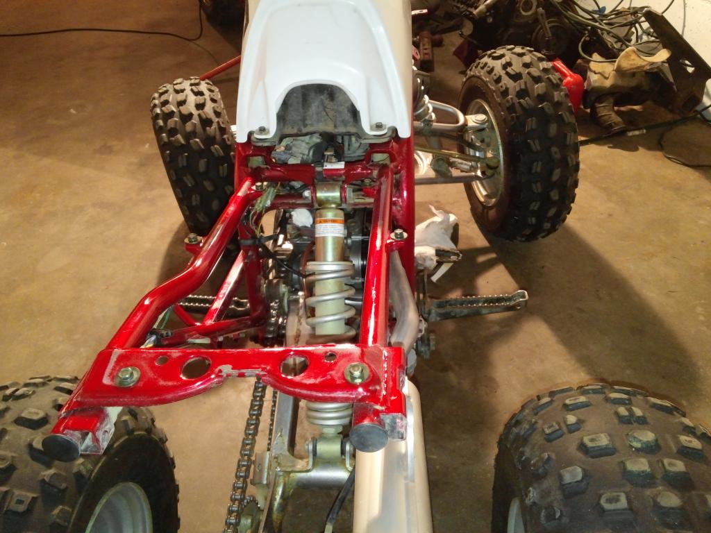

I trimmed the rear fenders. I like it. I want some heel guards. just not the stockers. Also, I am leaving the front fenders off since I mostly ride dunes. I don't mind getting muddy when I ride in the woods. So I bent the little fender tabs straight. Two 18 watt round LED lights are gonna get mounted there. I will probably disconnect the stock light. Just so I don't suck to much power. I may get a super small red LED light from Superbrightleds.com that runs virtually no power just to have that lit up red a bit. I think it'd look cool.

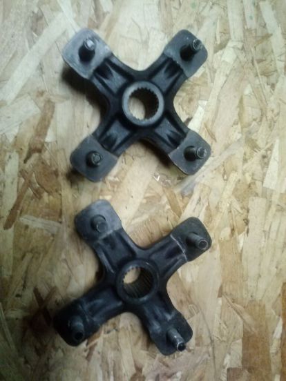

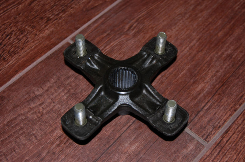

Bought some Shee hubs, they should be here in a week. Gonna throw these on so I can run a normal lug pattern and wheels are easier to find. I already have some ITP rims and tires. So this will let me run in the sand!
I will keep my blaster hubs/tires/rims until I find another set of yamaha rims/dirt tires. then these will go up for sale on teh cheaps.

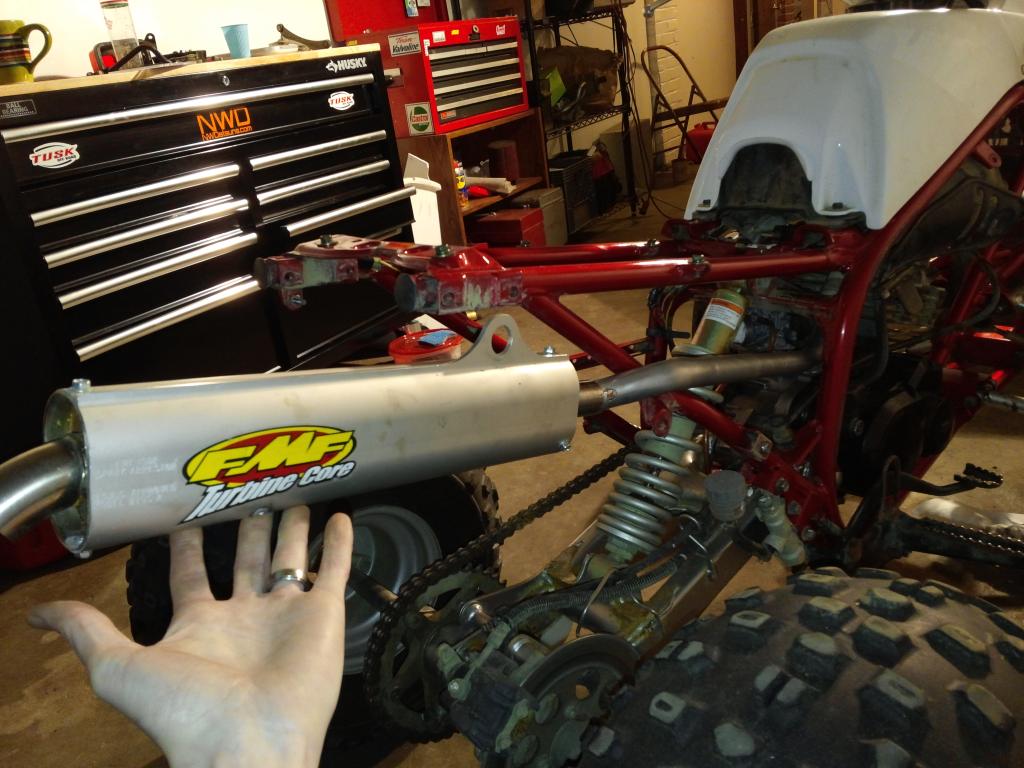

My banshee rear hubs arrive monday. I went over the bike and double checked all bolts. I found out my carb is leaking in this process. I may need a new bowl gasket, but I think I just need a new bowl all together. Someone hit it with a hammer and made a dent in it. Anyone have a decent stock carb bowl they can part with? Also, someone gave me a FMF muffler off a suzuki LT250r. It's brand new. I just need to modify the stock tail pipe to make it work. Should be easy, just haven't got to it yet.

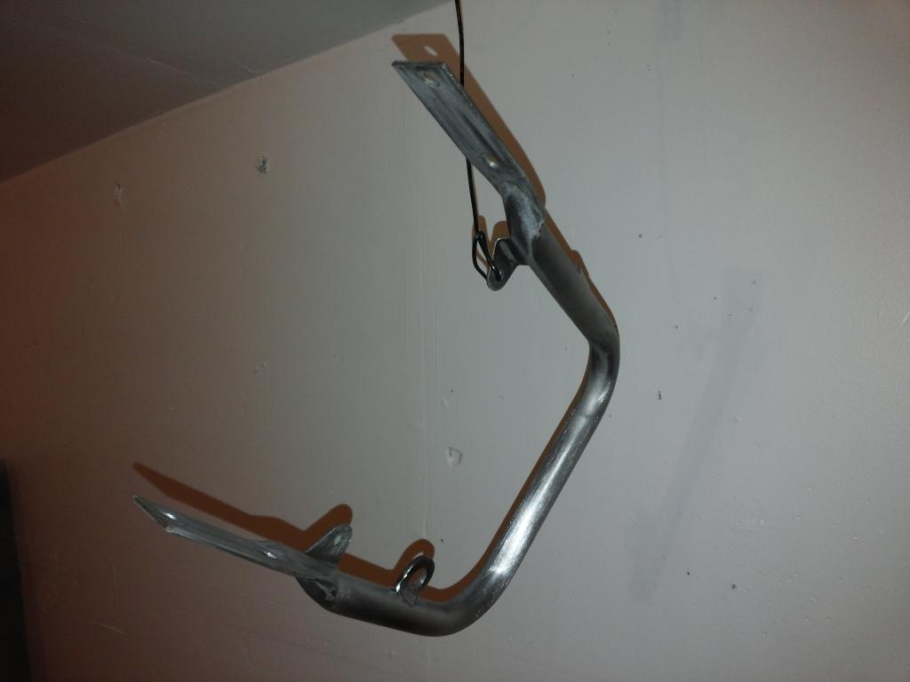

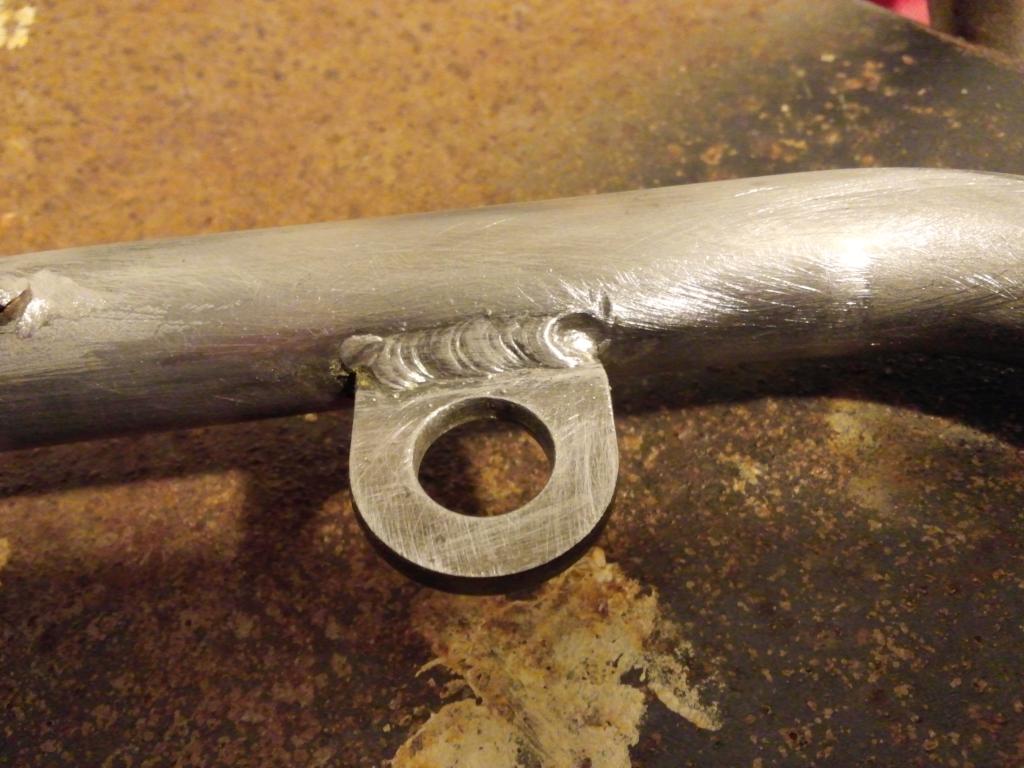

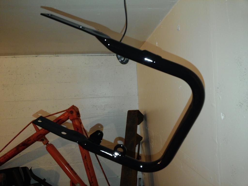

Got a little work done. Mounted up a silencer off an LT250R. I cut the stock muffler pipe, and the LT pipe and massaged/played with, tweaked till it fit. just need a rubber deal for the mounting tab on the silencer and it'll bolt right up. Main issue with doing this. the muffler is kinda big. It's going to end right where the grab bar ends. Also, leaving the stock flag mount in the way. I cut it and moved it. Then painted the grab bar black. The frame is red, the plastics are white. I am going to go with black A-Arms and swing arm. I like it better than silver. I will do powder coat when $ comes in, for now epoxy paint.
pics cuz posts without pics are terrible! haha
