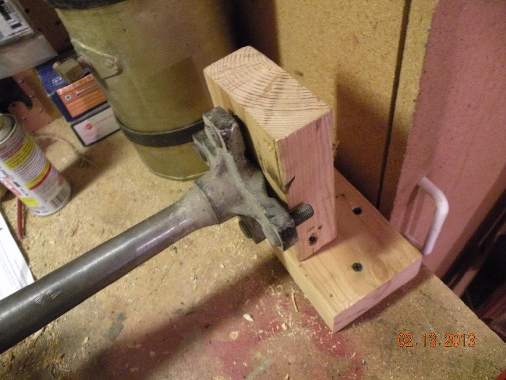

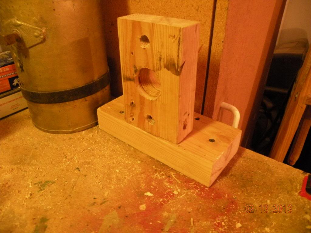

I made a jig of some sort to hold my axle while its off my bike, so i don't have to have someone to hold my axle while i was loosening the bolts. There might have been an easier way to hold my axle but i felt pretty damn smart when i thought of this.
Pretty self explanatory.

Even with that jig i still couldn't get the hub bolts off!
