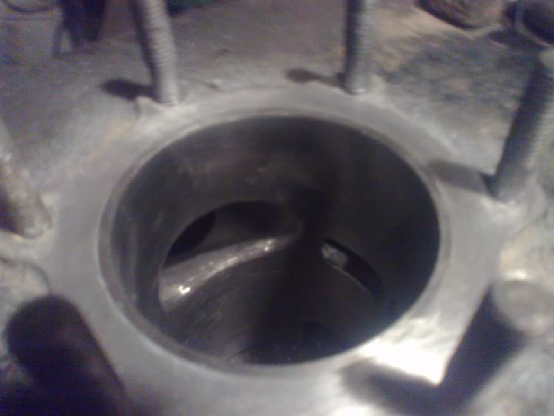

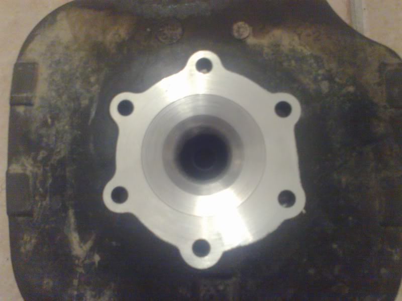

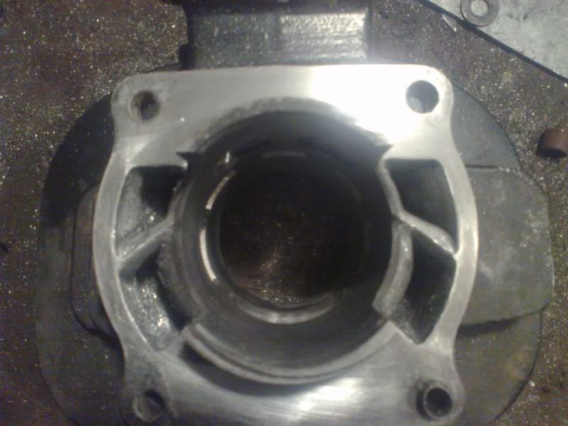

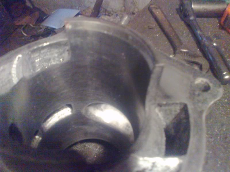

i do some port work once in a while for local guys. i do not offer this to members online, sorry. if you need portwork go to Flotek Performance. anyway here are a few pics if anyone cares to check them out. no intake pics, sorry. intake is just raised, lowered, widened, knifed and the boost port worked. thats not where the power lies anyway. this is 95% complete. it needs some final touches, this is where i stopped today. the head is also getting rechambered and cut.

there a few different theories on what works the best to get the most through that divider, a knifed edge is not bad and will flow alot better than stock. if the transfers are not worked the whole way through they are just going to be bottlenecking anyway and it really wont matter.
