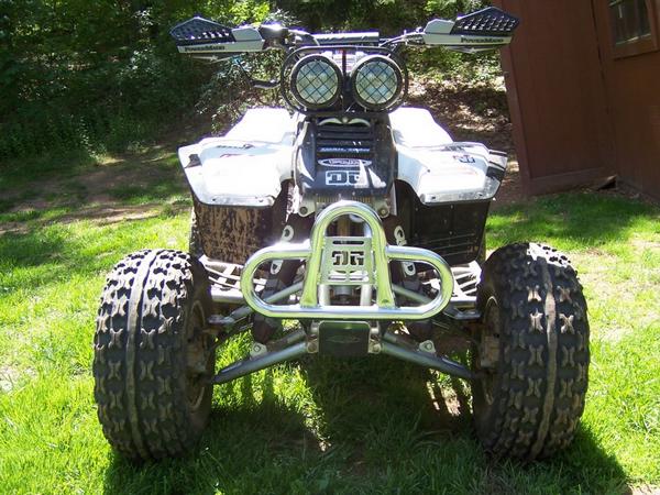

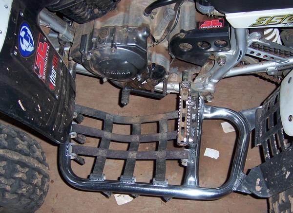

A mother's buff ball on an electric drill is the way to do it. Just pick the right polish for what you're polishing. You can also use this for polishing up aluminum nerfs, bumpers, grab bars, wheels, etc. Just use chrome polish for chromed steel, use mag & aluminum polish for the aluminum parts, etc, and don't try polishing something that's clearcoated. The only brand I ever use is Mother's, it's a little more expensive than some, but it's the best sh*t out there PERIOD. I'll look for a couple pictures of aluminum stuff that i've polished by hand with mother's polish, it looks like a mirror.

Found a couple old pics of stuff I polished. This was even done by hand, you get a better finish in less time when you use a buff ball on a drill. Before these were polished they were very dull looking and weathered, just looked like flat gray primer.
Try doing that with sandpaper.
