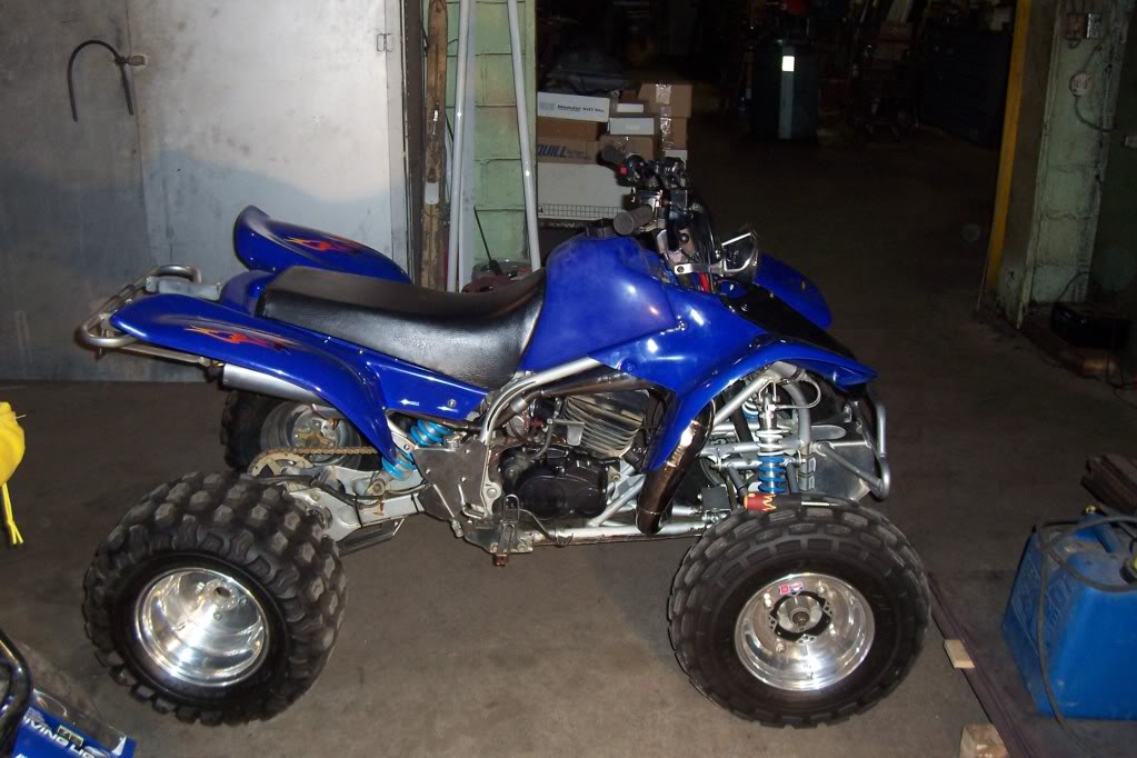

The banshee fenders did not fit as easy as i was hopeing. I had to cut the hell out of the middle part of the fender under the seat. None of the mouting holes fit right. I made brackets to bolt to the blaster frame mounts and to fit to the fender and drilled some new hools in the fender.
If I get some free time I will take it all apart to take some pictures to post!
The big fenders r great 4 keeping the mud of. After I extended the swingarm I got a little muder then I was used to.
Some pictures how I mouted the fender

what exactly did you do to get the plastic to fit?
I made brackets to bolt to the blaster frame mounts, and used some stock holes and drilled some new holes in the banshee fender to mount to the brackets. The banshee fender does not come with a airbox so i cut the middle part of the fender under the seat off and made a custom airbox.
The fender did not fit as good as i was hoping.
