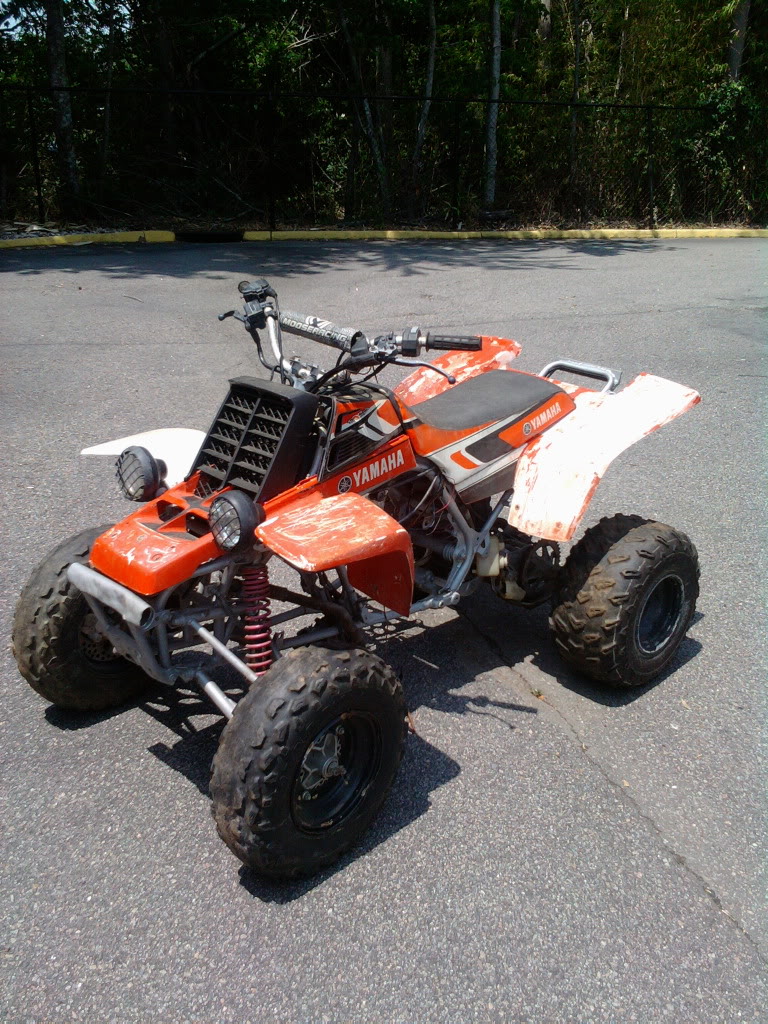

guy i work with had this baby sittn behind his house for a while. motor is locked up but i think i can get it fixed up. might take me a little while but i figured i could get a few pics of it now before i start tearing into the poor thing:D
not sure exactly what im gonna do with it but mainly a trail bike so not anything crazy. prob just ported and pipped. chances are i wont get a whole lot of tlc for this till i get home from busco this next weekend but we will see.

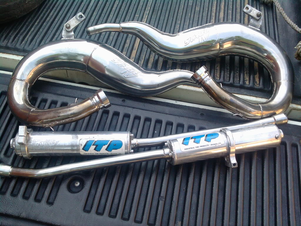

got a goood deal on these so maybe ill runnem. gotta talk to the builder though :)

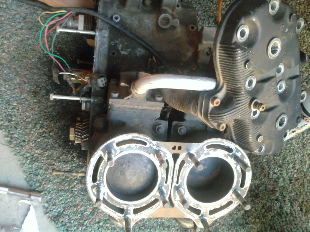

was also able to get the head off and measure the bore thats stock! and get it free'd up some at least i can take the jugs off.
wow shes rough bro!! but i am sure it will look totally different when ur done, good find, ur lucky to come across someone who doesnt want an arm and a leg for it, lol
Thats alot better then what I started with even though I'm not complaining at all. Don't get crazy on the porting and you should have a very trailable bike.
Locked motors are gold mines- it's a 2 stroke how bad could it be?
Take it from me it's your life check the ball joints for wear. Check the upper and lower arms and the tie-rods for any slop and replace the arm or by new joints for the tie-rods. Check the swingarm, shock, and pivot arm bearings.
My shee had the swinger bearings seized, the shock bearings rusted up and the pivot arm bearing shot.
Def go through the motor with all new bearings and seals.
Sit on it and see if the rear shock is blown it's kinda common.
Pull the gas tank and see if it comes out freely, if the shee has been tweaked or rolled it won't.

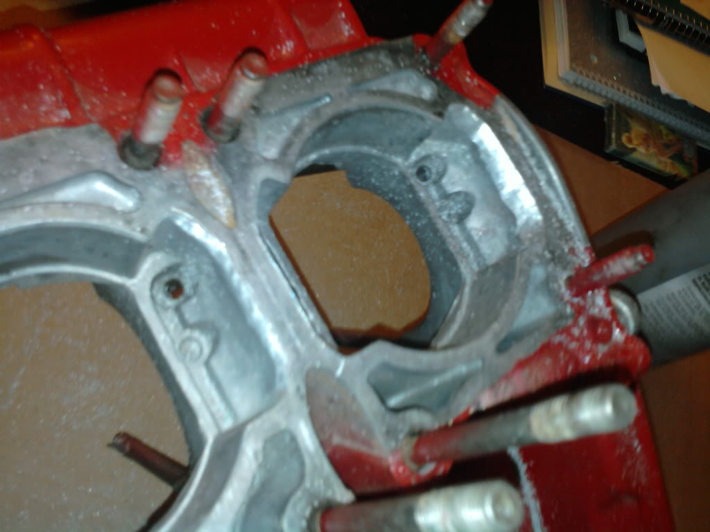

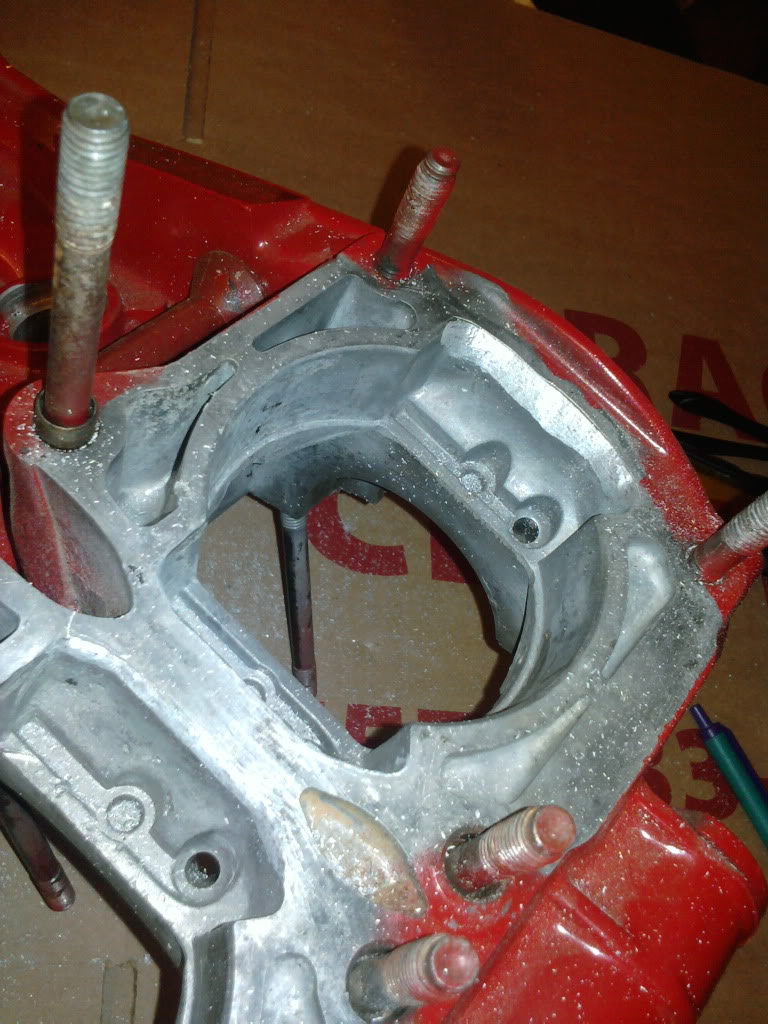

well i finally have some progress to report on this banshee. i had the crank looked at and replaced the bearings on the outside for safe measures. i then took the base gasket and trimed it to fit the bottom of the cylinders and then transfered it over to the cases and port matched them. should be assembling it soooon!
