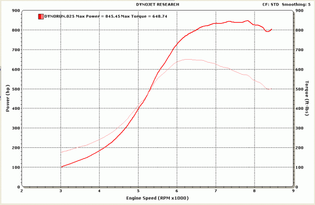

why would you want a supra engine in a off road vehicle? let me answer for you, you don't. and the 1jz is junk, only the 2jz is good.

the 2jz engine is better. and the supra engine is like a 2-stroke, make no power before like 4500rpm. they are a hi revving motor. they are not a motor made to be lugged around. they are made to be screamers.
