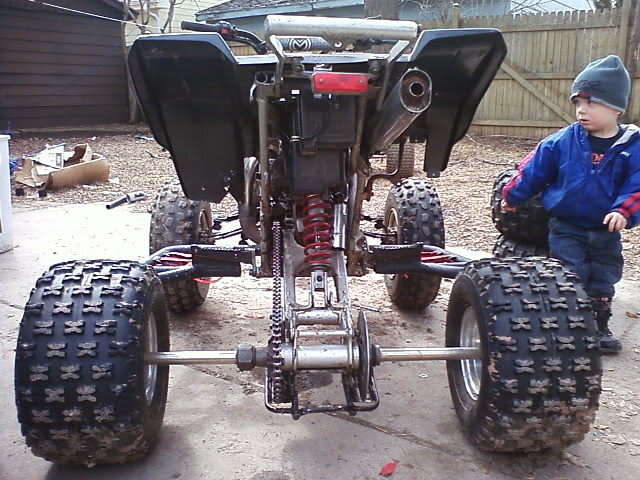

just wondering if anyone here is still around from blaster HQ about 5 years ago. remember this blaster?
2002 laeger LT PEP limited mass custom no link +3 round house swingarm with 250r shock "hollywood dirt productions" engine 34mm carb 250r air box LRD
its a round house style swingarm much simplier and easier to adjust the yamaha's dumb design. the bearing carrier works like a cam the axle isnt centered in it, it is offset so as you twist the carrier in the swingarm it moves the axle which will tighten/loosen the chain
Awesome thanks bro,lots of help,my friend has this same axle in his 300ex,do the 300ex's come with these or is it aftermarket? his chain is mad loose,now i can teach him something new :)
