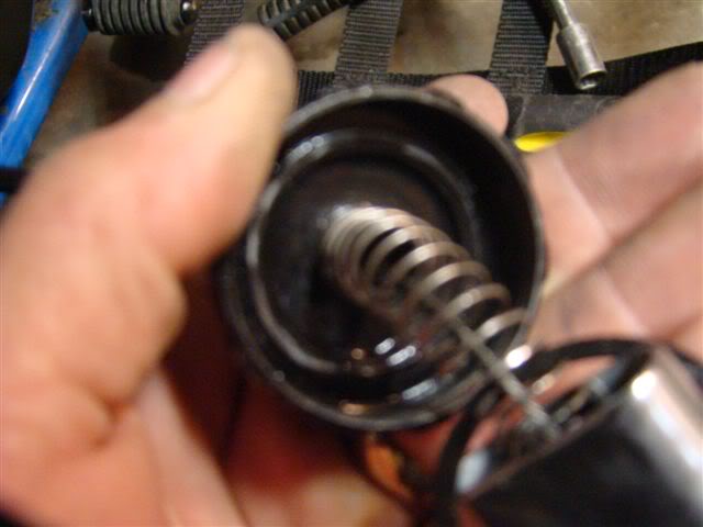

The same sand was on the underside of the cap. Look at the boot it covers the metal insert but not over the top of the cap. I'll fix that and i think I'll put grease around the outside of all boots and even around the carb top. And the cleaning thing....****** don't tell me I should split the cases again. The carb and top end fine, but the bottom ****** . It was such a small amount, how about a good rinse job? Thanks you both for your help, I'm sure the top of the cap is the problem.
Hey! I bet you nailed it! Yeah, clean that carb. cap out really good, seal it up, and maybe that'll do the trick. I think your engine will be OK if you just fix the leak, maybe do a rinse job (NO WATER!) and run it as normal. I might run a few tanks of richer-than-normal 28:1 mix in it to help purge the sand from the crankcase, but apart from that... just go on with life.
