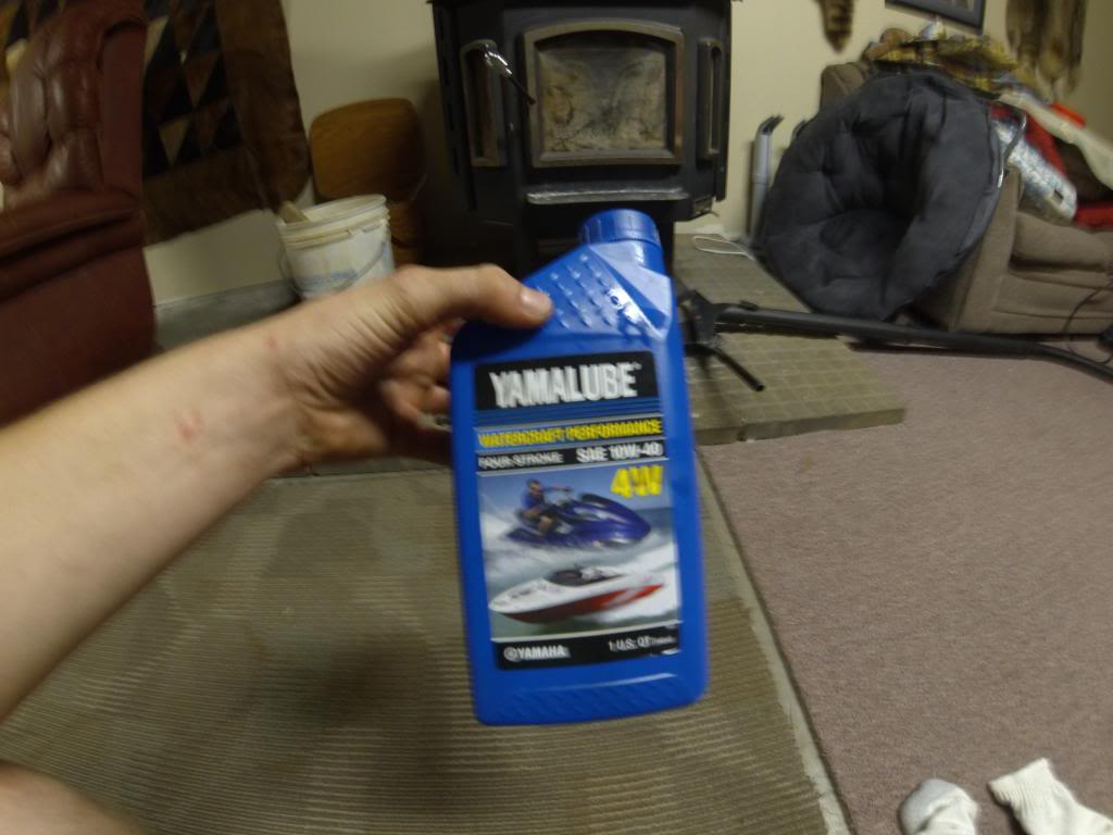

so today i installed my new clutch, tightened the spring bolts to the 4lb spec, i lined up the two dots, i pulled lever a few time to check that they spread out like they are supposed to so i thought everything was good......
i get on it and put it in gear, the wheels jump alittle like normal, but it slips alot, i rode it down the driveway and back, put it back on the table to fix it.....
whts wrong with it its driving me nuts?????

yep soaked oil plates, and the oil is same oil i used before when it was working great.
This slipping is the same as before i changed it, that's why i changed it cause the plates had almost new fiber left on them so i thought that what the problem was.
How long was it "working great" with that oil? I looked through Yamaha's literature and I couldn't find if their Yamalube watercraft oil is wet clutch safe.
alright..... i will be getting some new oil for it tomorrow.... is there any yamalube that i can use??
also.... i feel like an idiot now.... i adjusted the push rods the wrong way... so now i took it apart again and it works just fine,
my clutch had worked since i bought it last june till last week, on that oil...... but imma change it anyway.
maby i bought mine for $3 a quart because the person at the counter didnt know what he was doing so i bought like 8 or 9 quarts i think iv seen it at autozone
