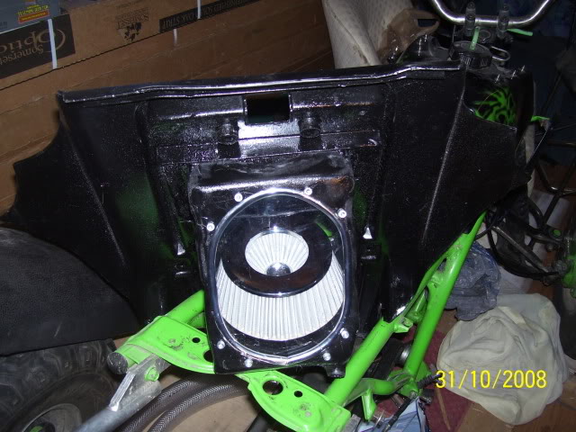

heres some pics of mine and batts airboxes we made
theres no hole its plexi glass.
did you ut the box out and move it farter back on the fender?
thats what it looks liek because the oil injections hole is gone
thats exactly what we did, completely cutout the old boxes moved them back and refiberglassed them back in place, backwards with the plexiglass to see into the box

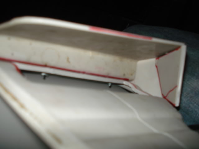

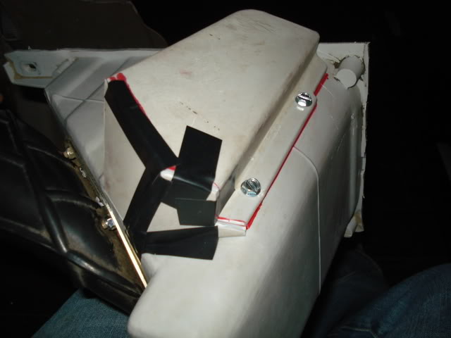

alright, started modding up this old air box.
i hope that its going to clear the frame
keep in mind this is just a mock up, nothing is even glued yet its just taped so i could see what it looks like

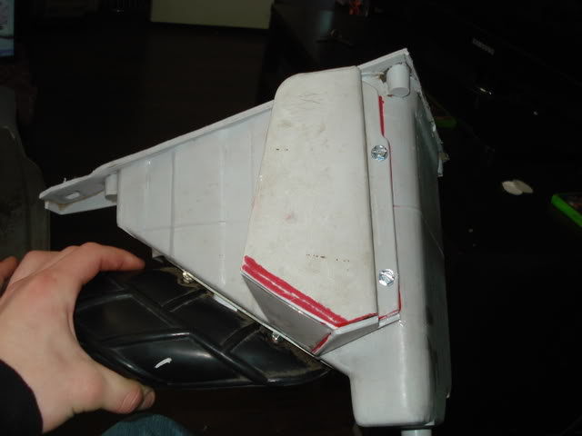

also with this raptor fender that i will be putting on there is no airbox, just a little tool compartment that i will be cutting out so i can move the air box back further.
also the fender is more open where the scoop is compared to a blaster fender.
now i gotta remove the oil injection!!

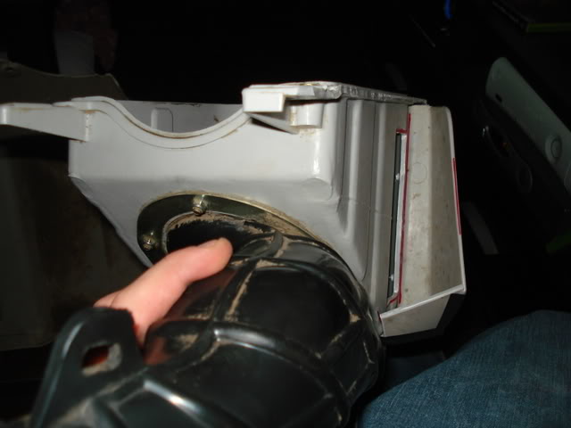

test fitted did not fit so i had t cut a peice of the scoop off as you can see in pics, so i have to paint that spot.
also added some stickers and i glued a filter in there haha
