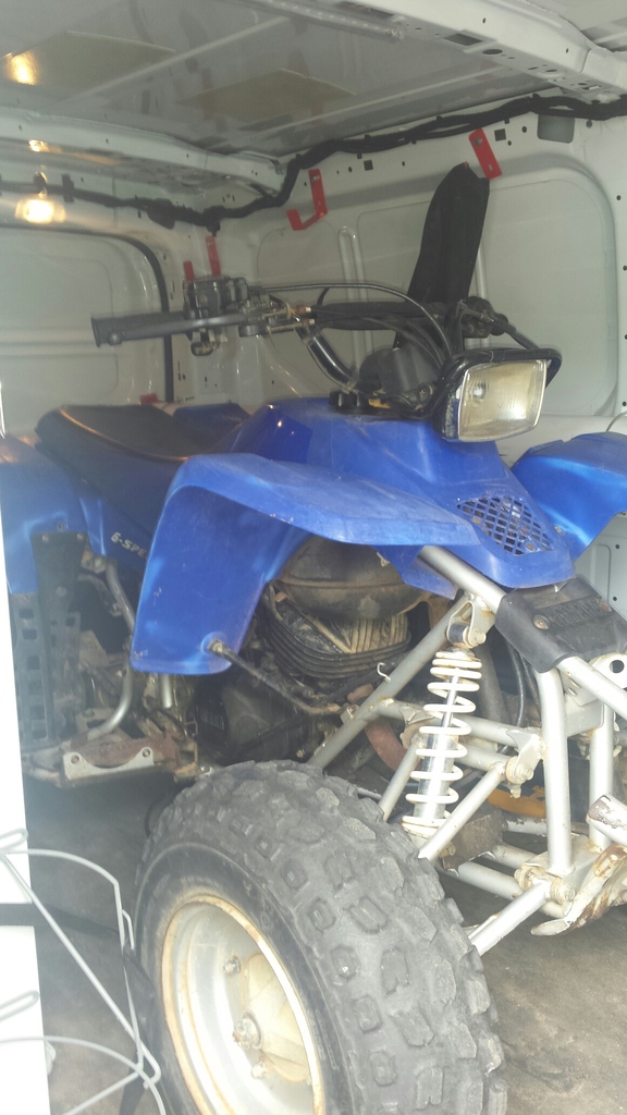

I picked up a non running Blaster from a buddy of mine that had too many projects. He bought it, kept it for a week or two and sold it to me.
The guy he bought it from had rebuilt the top end at some point, and while riding it, it locked up.

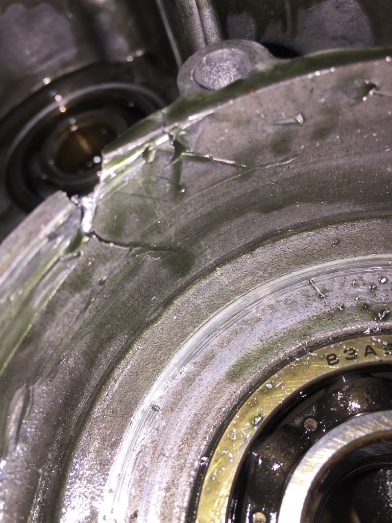

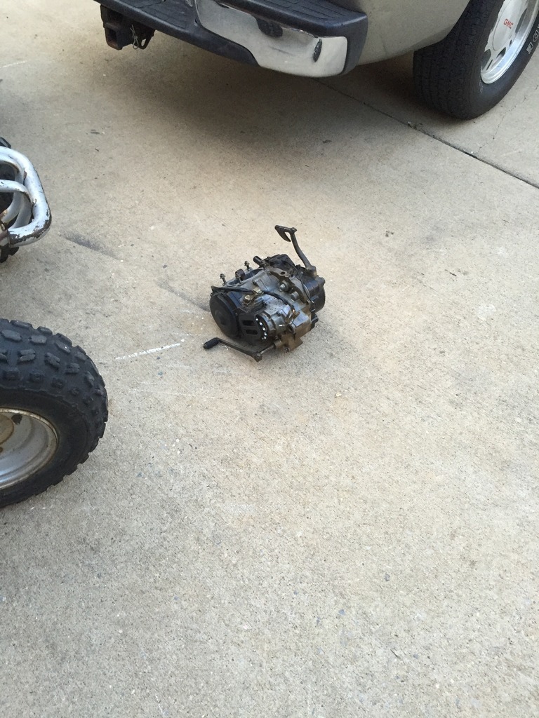

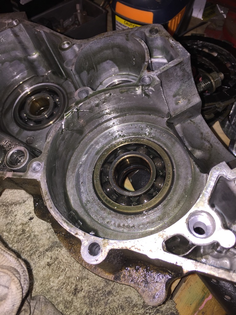

Anyway I got it home and took the top end off to survey the damage. The wrist pin bearing failed and dropped pieces down into the crank. A little chunk of the piston also broke off and went down in there. At that point I knew I had to split the cases so I pulled the engine.

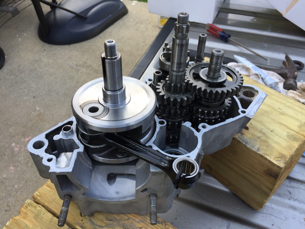

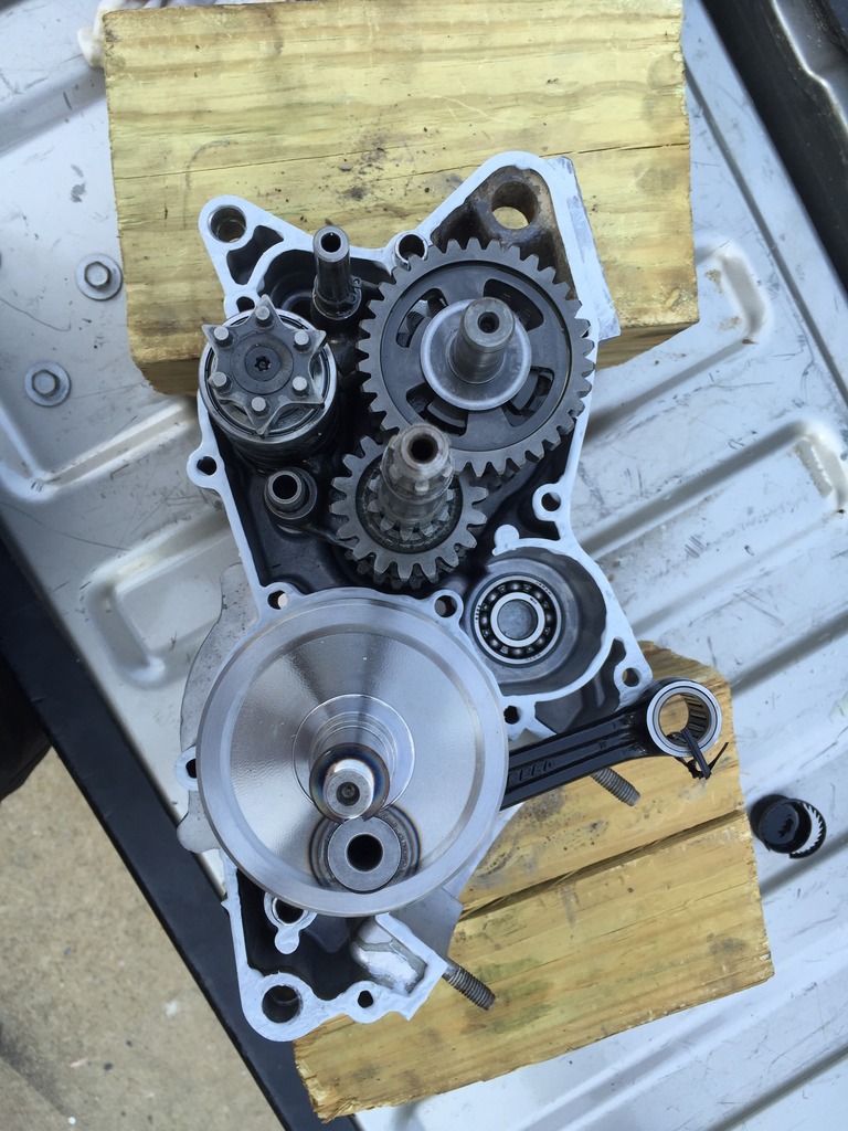

I got the bottom end apart. The crank had a little damage and the rod had a tight spot in it when turning it. The fragments that got down in there got wedged between the case and crank and tore up the left case half.
I ordered a new crank, crank bearings and all bottom end seals. I got a few parts on the way from KOR. I've also bought some case halves from a member here. I've got a new forged Wiseco piston.

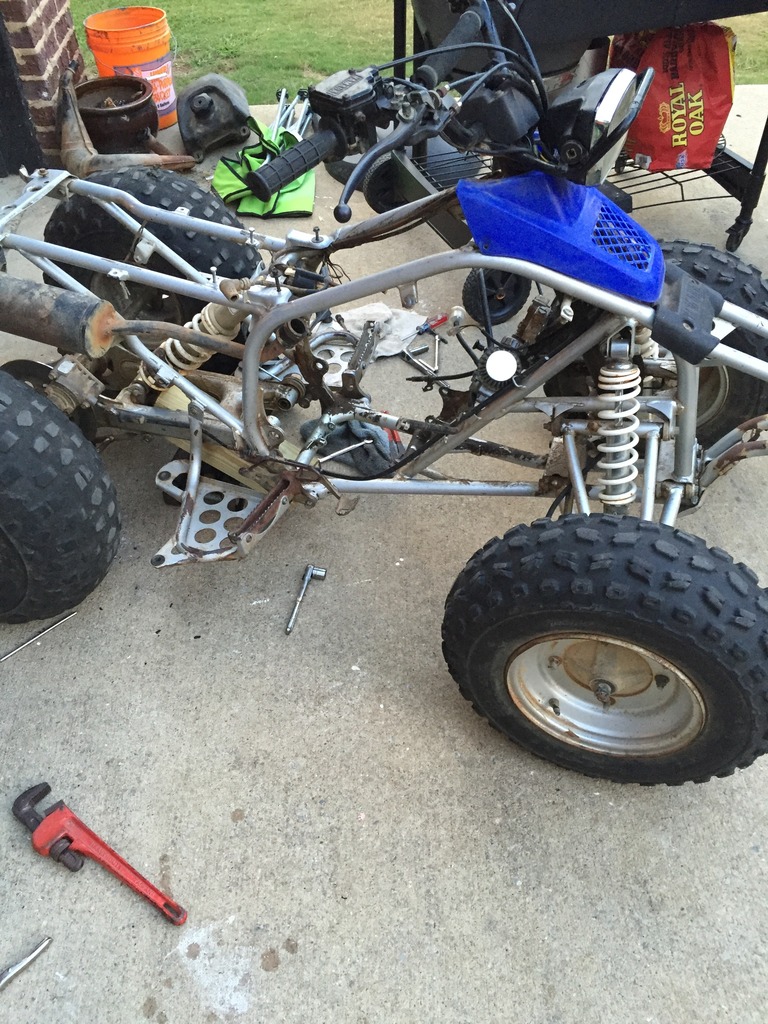

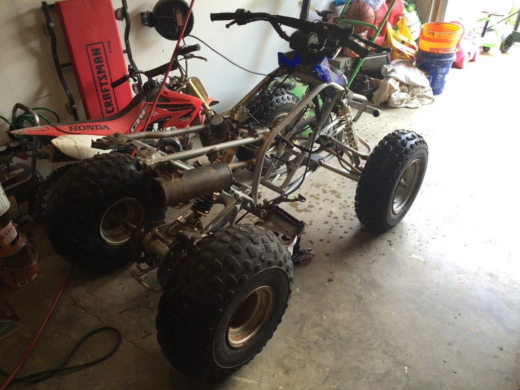

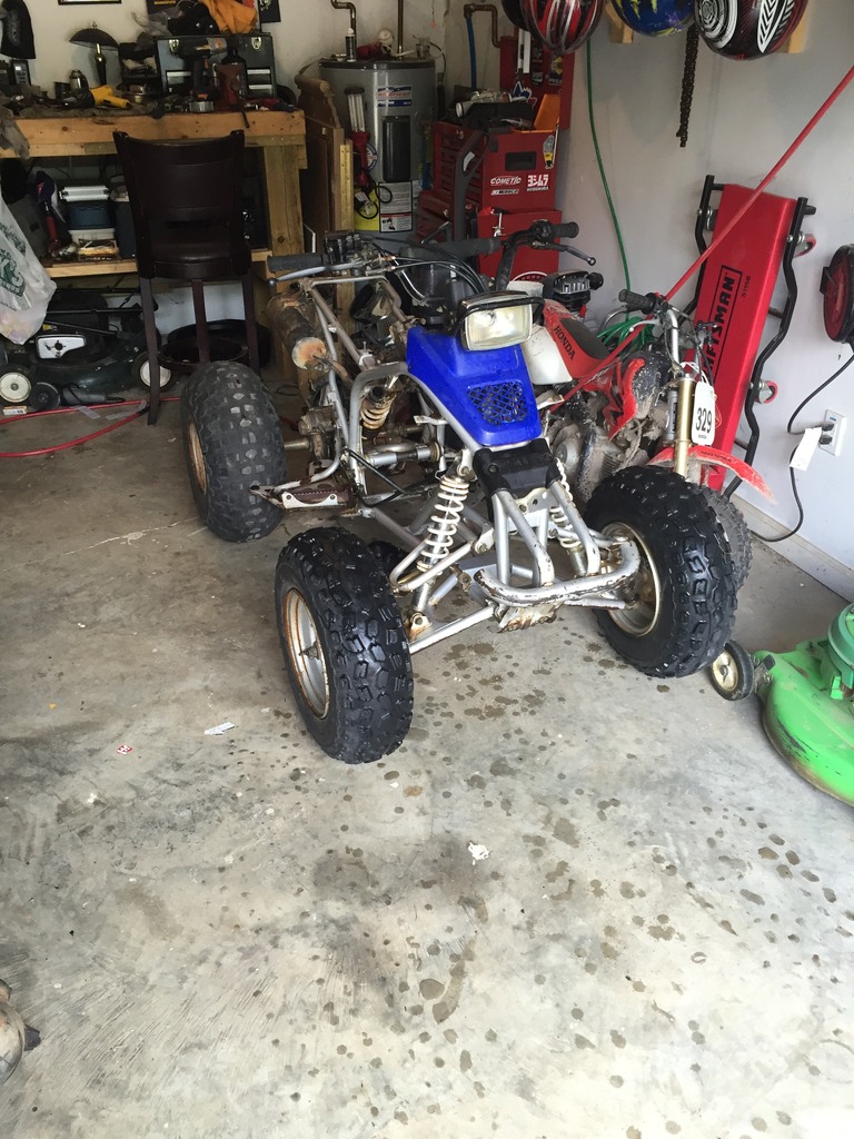

I rolled the quad out today to clean the frame up a little bit. I thought about stripping it and painting it, but I'm gonna hold off until I get the engine back together and running good.
Here is how it sits now, pretty much the same-
