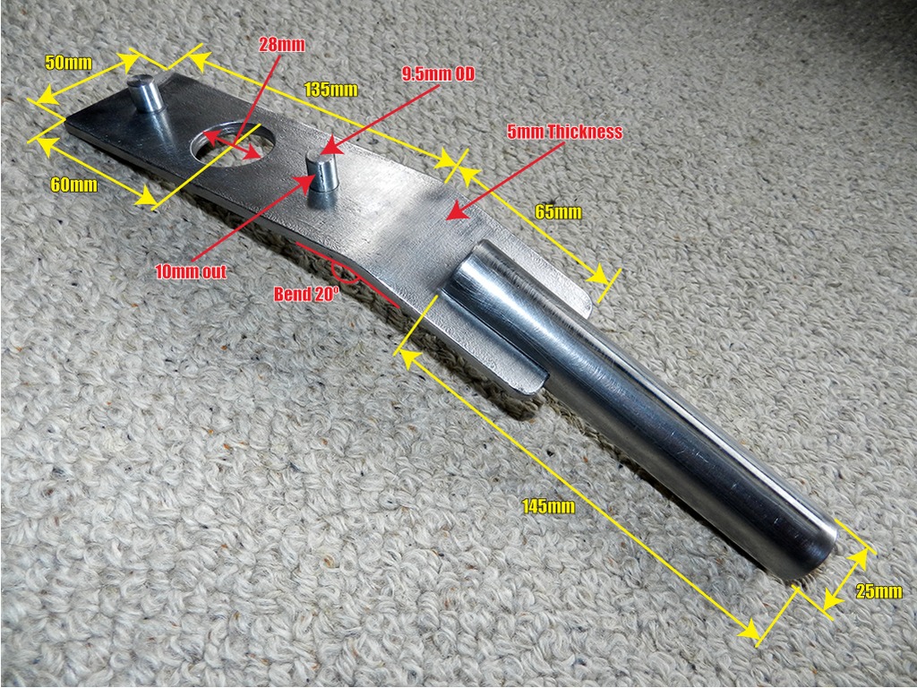

Left side = Stator behind flywheel. Should be no oil, Fuel or mud in here.
Sounds like crack seal is leaking. It can be replaced without stripping the engine. You will need a fly wheel puller. Cheap on ebay.

This is what I need correct? Already have air filter on order, and speedy I have the 05 still I actually picked up the 2 today for my step dad and brother , and plan on helping them get them up n running to specs so that's why I said I picked them up
