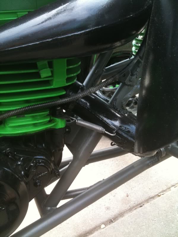

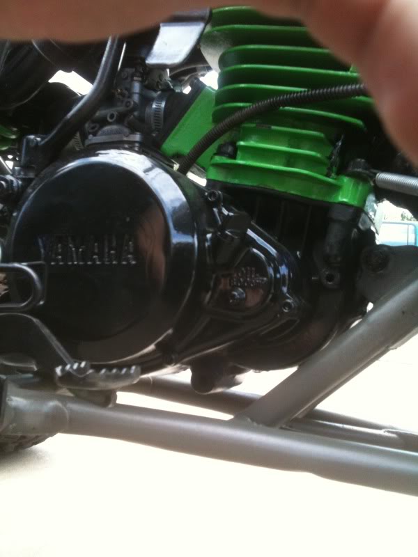

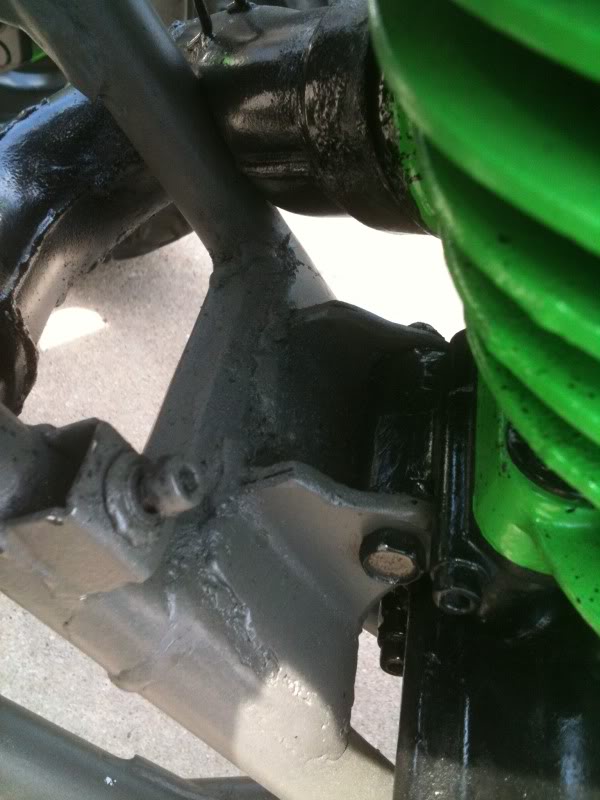

Heres some closer up pics of the top end and the front mount.
Its not the most professional looking finish but it works great and that's about all that matters since its still got to go back under the knife at one point to add the 3rd mount from the bottom of the motor, but since my welder reassured me that the only way the motor was coming off was if the frame came with it.
