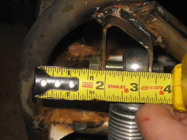

I'm wondering if these bushings would fit the front if you converted to 250r shocks? I have some triple rates that have some space left over once the shocks are mounted...well quite a bit just like the rear. If so...you would be in for a set from me as well

Ok...here's a pic of the way the 250r Works shocks fit in the stock location of the frame. Looks like there is a 1/2" difference. So if the bushings are 1/4" thick, then they would work on each side. The stock bolts that go in the front blaster shocks, fit the 250r shocks well. Here is a pic:
hey callmej75, that's what the tops of my shocks look like as well, straight from works you get spacers to take up the slack
