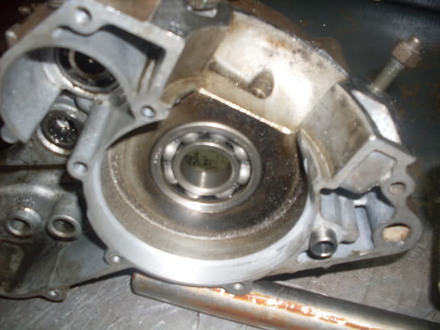

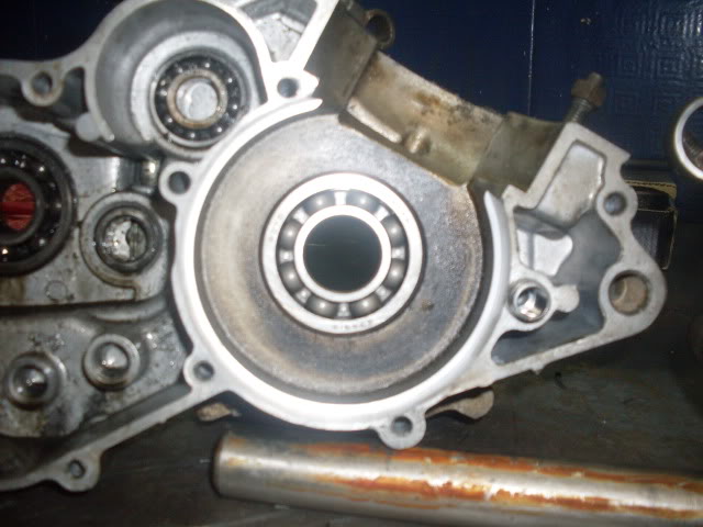

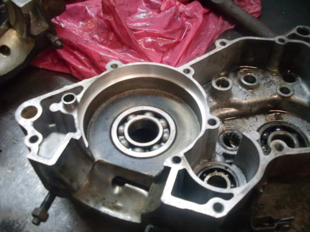

Looks good. Hopefully you will not experience a failure between the balancer and crank passage. When I picked up my used stroker motor that I planned to rebuild, I found both cases damaged in that area. We found that who ever did the work before machined it with .04 clearance which is double what hotrods says is the minimum. I think were going to shoot for .03 when I get my new cases bored next week and if it is too thin he was considering to attempt to dynamically balance the crankshaft to do away with the balancer, and that would give us room to strengthen the passage. Time will tell...
