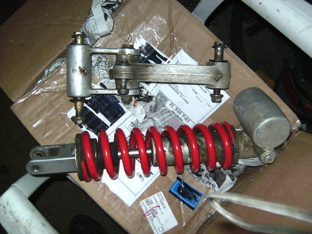

New plan for rear suspension.
z400 rear shock as I can find them all day for about $30 shipped.

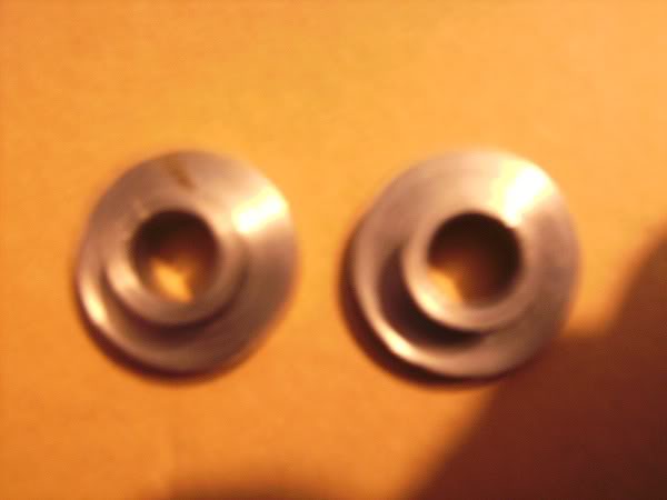

I just ordered the conversion bushings from Ken O'Connor Racing.

Good luck let me know how it goes i might do that mod here soon
It's actually pretty straight forward.
The only real work involved in the mod is drilling out the bottom mount on the shock to fit the stock blaster mounting pin.
And either cutting or reforming part of the air box with a torch so the reservoir doesn't rub.
Here's the z400 shock, I found the cable for my camera finally.
Just needs to be cleaned up.
