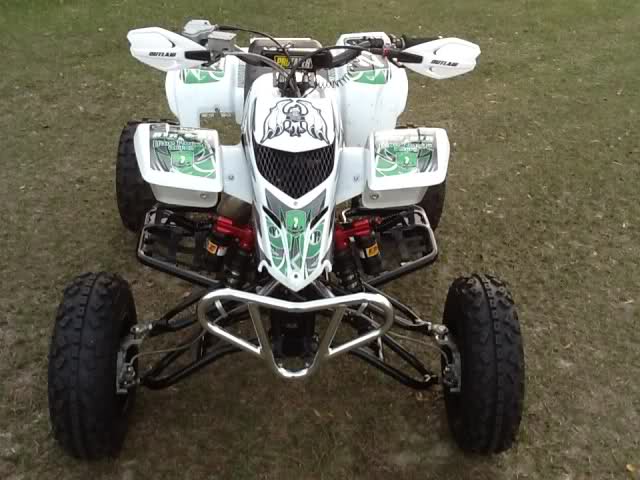

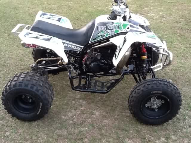

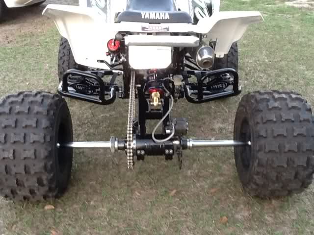

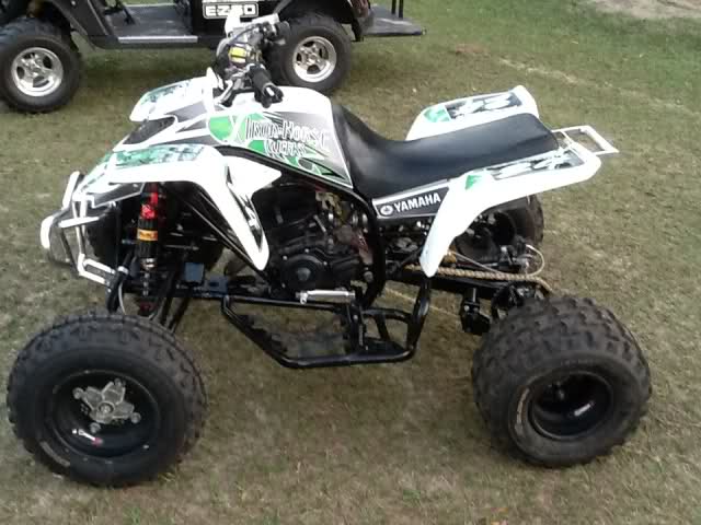

Here are some pics of the before and then the after. We just completed a full restoration on the race quad. Complete frame up teardown, replaced all bushings in arms and all bearings in swinger & chain with new chain rollers and the slider also. Full blacked out powder coat, frame, arms, swinger, rear hubs, sprocket hub etc. Polished the bumpers to a chrome finish including the pipe coupler. replaced FMF with a right bend power pros, added handguards, blacked out the grille and replaced all graphics. Also had a spare all black seat and shaved it down 2-3 inches to lower the rider heighth.

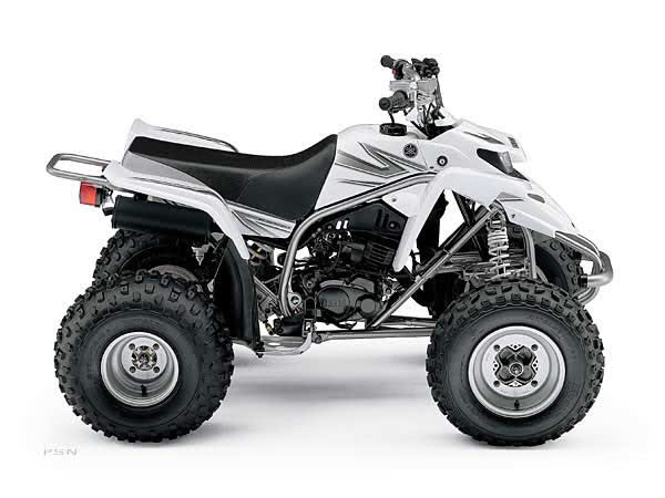

2011 build Before:
2012 rebuild After:

2011 build Before:
2012 rebuild After:
