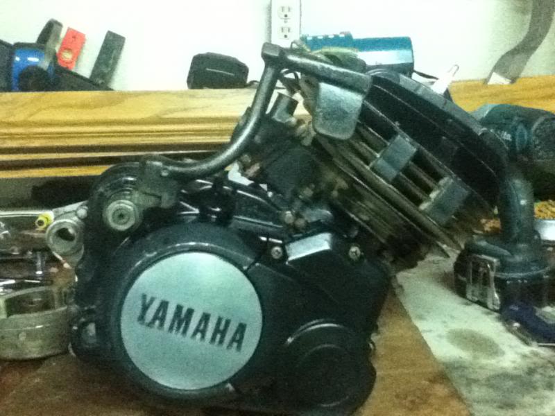

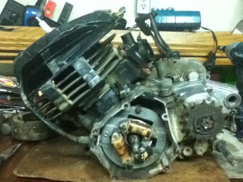

I started working on this motor again the other day. I have the clutch side reassembled, and I got the new stator today and put it on. Just waiting for a die to clean up the crank threads. This has taken longer than expected!
I did get the crank threads straightened out. I bought the m12x1.25 die, and got it to chase them back to good. Thanks again for the info on the die size Blaaster. I also changed the Phillips head screws on the stator and oil pump covers to Hex head screws.
The motor held 7psi for 15 minutes, and is Leak free now, I may put it back on the bike tomorrow if my neighbor is around to help hold things in place.
