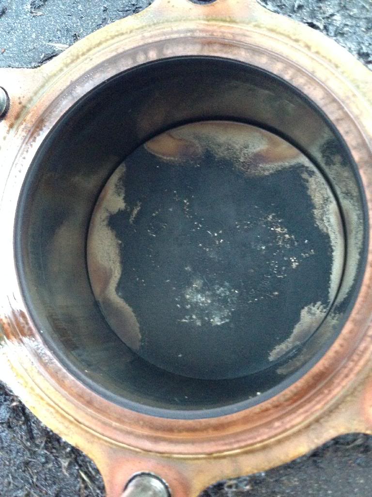

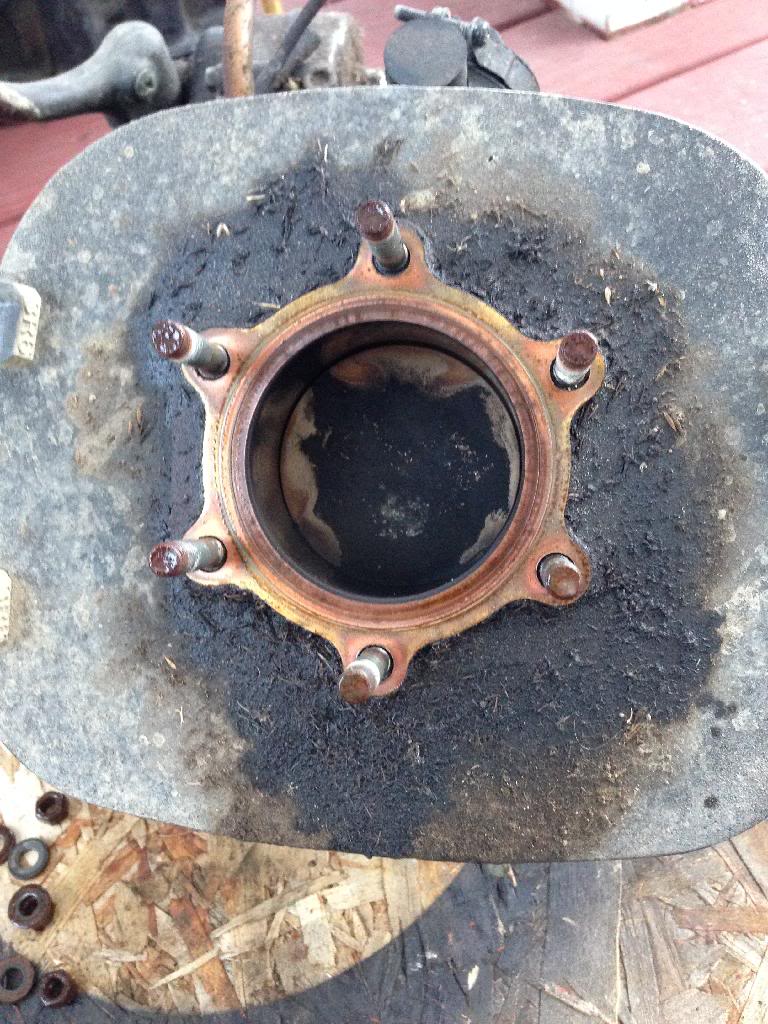

There seems to be a lot of room between the piston crown and the cylinder, or is it shadow?
Does this piston look like it's my problem of the blaster bogging down randomly in the upper gears?![]()
Pistons seldom cause bogging, it is more than likely that poor jetting or and air leak will be the cause.
