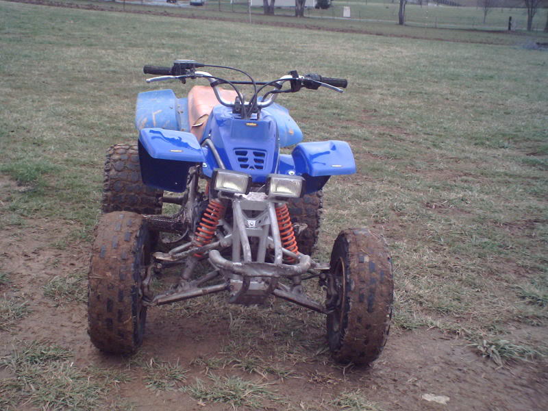

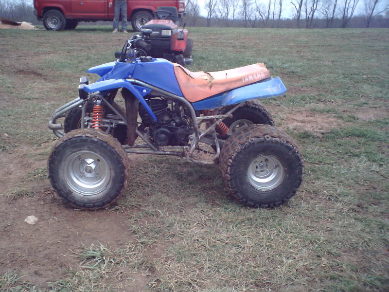

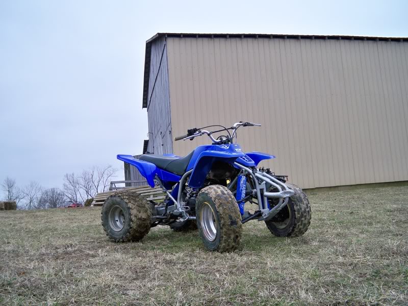

UGH! I hate 22". Those tires are just too big. I would run a 21" at the absolute max. 20" to me seems appropriate, but I run 18" Fast Trekkers. i have no issue with jarring or whatever it is ascosciated with small dia tires. Check my bike with sh*t Trail Pros and Good Fast Trekkers.:
