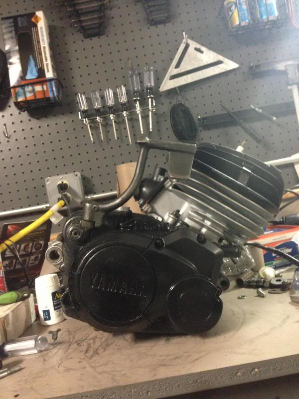

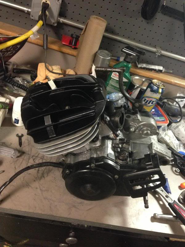

Ok guys, here's where I'm at...I had a bottom end rebuilt by someone who is reputable so I had a good base to start with. The top end I have a ported jub which was bored to .050 I believe (also from a reputable machine shop). The shop ordered me a Namura piston and a new bearings and a cometic gasket.
I went through Ken O'Conners rebuild instructions as well as going alot of research before hand on here too. so Im 99% sure everything went together as it should. cleaned jug, oiled rings, torqued, the whole 9. got the engine in the bike and started going to town wiring it up and removing TORS and the e-brake.

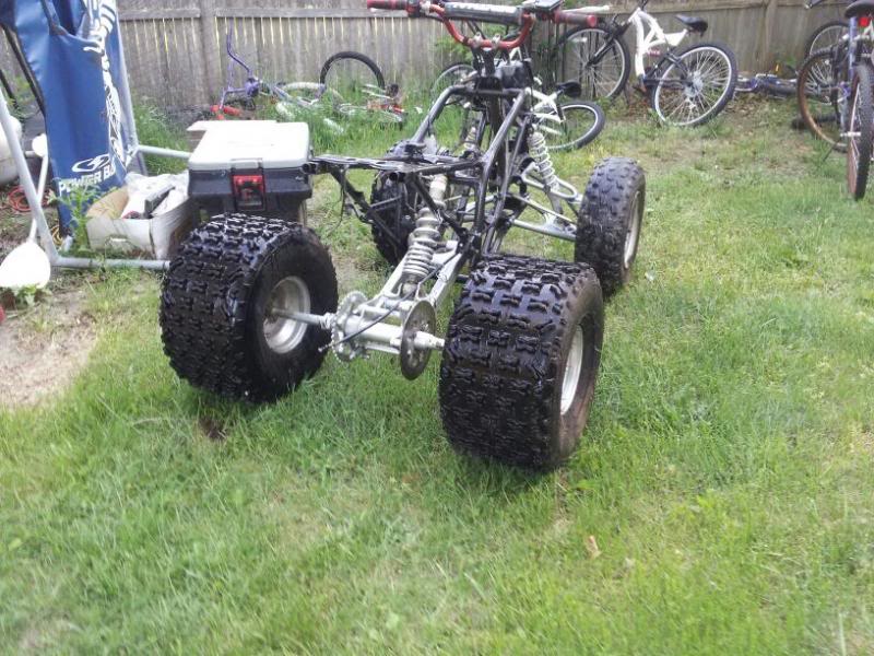

The bike started out as a roller with a box of parts. The previous owner blew the top end and messed up the bottom end and cases too. I got a parts bottom end and a head but no jug. flywheel and stator were removed and in the box. along with the carb and everything else but the suspension and wiring. He had painted the frame from a beautiful SE anodized red to a graphite color. X(
Here's some pics of when we picked it up

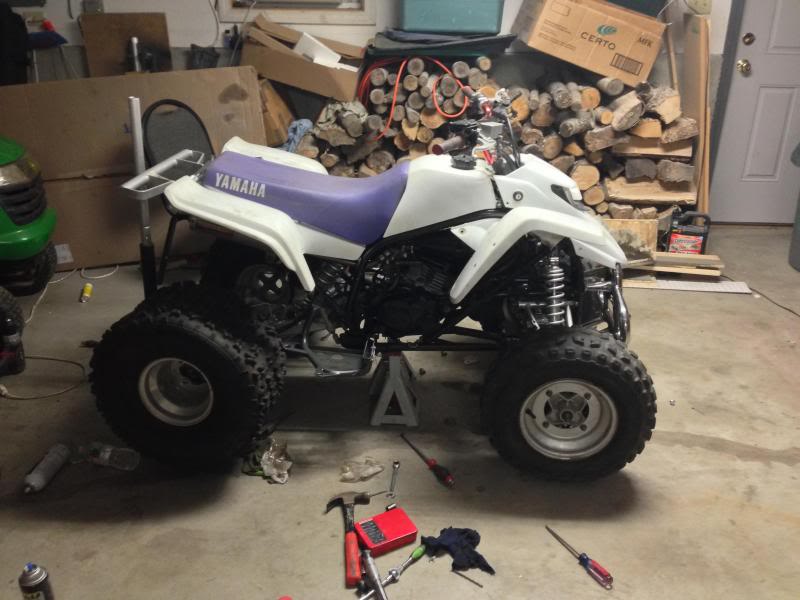

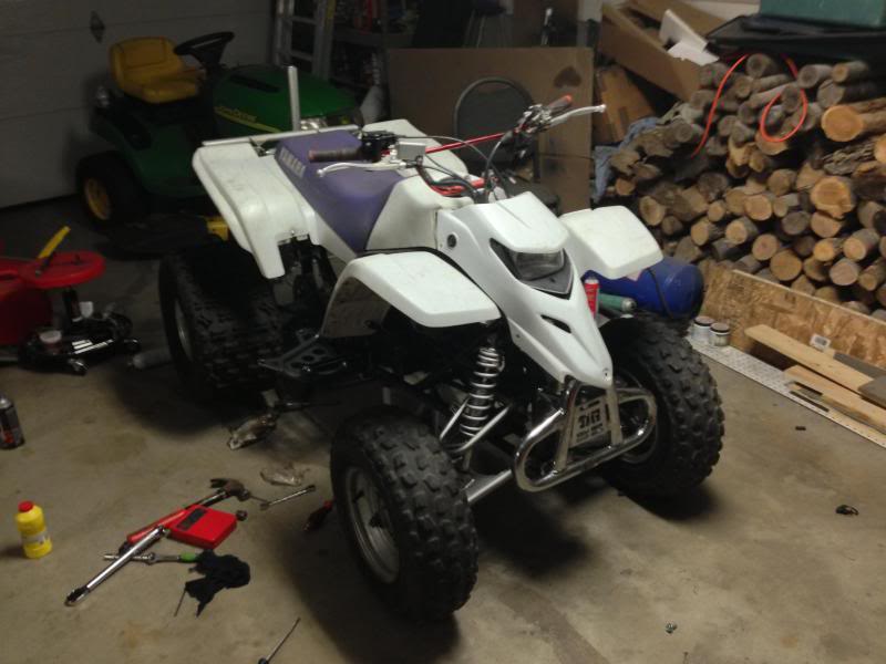

How it sits now w the new engine!
