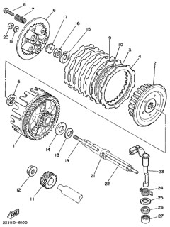

my 01 blaster clutch was not working when I got it. it was stuck in gear and I could drive it but not use the clutch. my actuator arm has been sticking forward. I got new steel and fiber plates and springs. soaked them for 24 hours.
I installed in proper order according to the tabs on the steel plates. I lined the pressure plate up also. it was still stuck in gear and the actuator arm was still sticking forward.
I took it apart and could not find the ball . tipped it on its side and no ball came out. I got a new ball and outer rod and installed them. The clutch now sticks so that it won't go forward in gear and if I ran it then im sure it would just rev and not go forward.
I have played a bit with the adjustment rod in the center of the clutch. I have lined up the actuator with the line. The odd thing I notice is the actuator (shifter side) seems to rise out of the case a bit when it goes forward. I can move the arm backward but it takes a little force. spring seems ok. any ideas? Thank you in advance.I:I

I didn't read all of this but I'll bet the ball is welded to the rod and now you have two balls :o. Unfortunately you may have to split the cases to drive the rod out of the shaft.
Ball welding can be caused several ways. Long downhill with clutch pulled, or anyother extended period of pressure on the ball. X(

I would check the rod that touches the arm. It could be bent or crapped up making it stick. Your best bet is to start checking each part of the clutch system to find what's wrong.
thats the only thing i didnt check. that will be next. I did look at the manual. all i removed so far was the plates, outer rod, rod nut/washer pressure plate with the 5 screws/washers.
That ball bearing has a habit of falling out sometimes. with the cover off, and everthing disconnected, pull the clutch lever does the pressure plate move away from the clutches about 1/8" or so? If not start with internal adjustment. make sure the cable is disconnected from the clutch arm or the lever before you do this.
finally a break in the rain. got out there and moved the carb. gave the clutch actuator a tug and it came all the way out. I would think the inner clutch rod isnt there but wouldn't the outer rod fall down inside?
oh and I tipped my bike to the side after pulling the outer clutch rod out and the inner one is nowhere to be found. any ideas?
