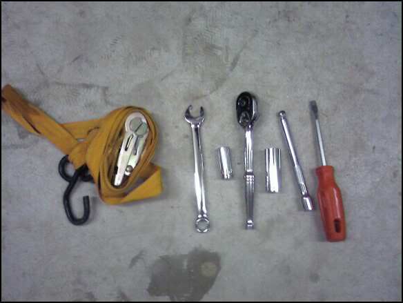

Tools: Ratchet, Extension for ratchet, flat head screwdriver, 14 and 17mm sockets, 14mm wrench, ratchet strap

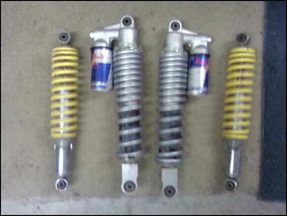

Heres a pic of the difference between the two types of shocks.

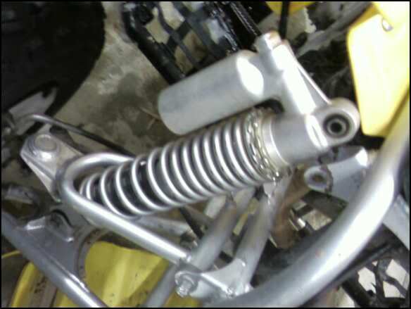

3. put yfz shocks into position and using the stock bolts from the blasters shocks bolt the bottom of the shock to the lower a-arm on both sides,but leave the bolts a little loose to have a little wiggle room for aligning.

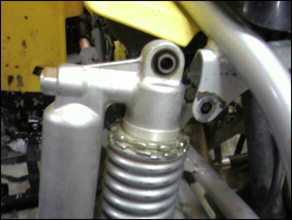

4. the shock will still be about 3/4 of an inch from being able to be bolted in at the top, so use the ratchet strap and ratchet it down to compress the shock just enough to be able to be brought into alignment of the stock bolt hole on the frame, using the screwdriver for aligning.
5. then reinstall the upper shock bolt.
6. tighten all the bolts firmly and you're done, be sure to go back and check the bolts and make sure they are still tight after riding for a little bit.

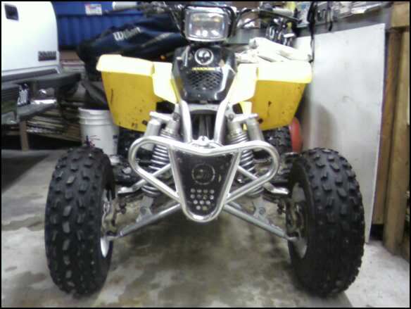

^^pic looks like the blaster is leaning but it was just bc the shocks needed some adjustment.
