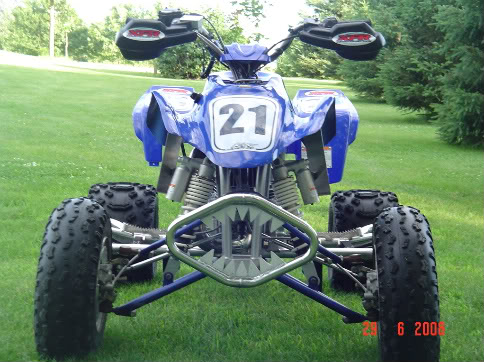

The one benefit of the yfz's is that there comp & rebound adjustable so you can fine tune them where as the works aren't. If whoever is willing to valve the works for your weight then I'm sure they'd throw in a 1/2'' spacer to shorten the yfz's. I ran a set of yfz's on standard travel burgard +2+1's. I weigh about 150lbs and they rode nice. Honestly, it'd be a tough choice between the two
The yfz and the works are from two diffrent people . Did you have any ball joint problems with the set up? And it seems really tall did it sqwat a good bit when you sat on it?
