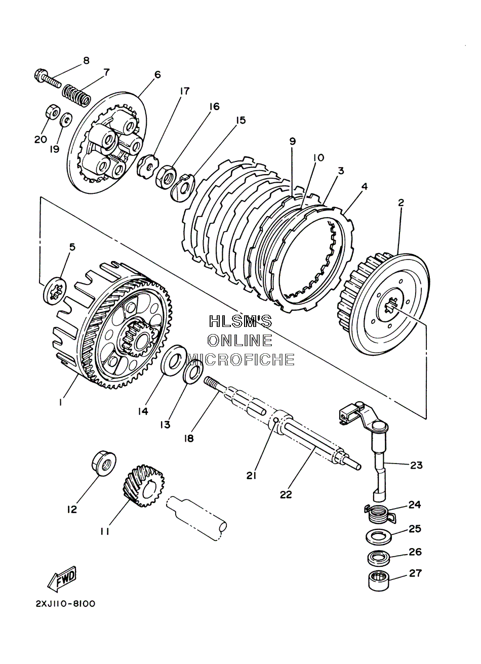

That's the wavey spring washer. It's supposed to be there. It goes with the 1 disc that is different from all the rest. In the pic below, 10 is the wavey spring. 9 is the special disc. Put them in the order shown.
Is there anyway specific way of telling the difference between that plate and the rest?
The hole in the plate is bigger, because that's where the wavey washer goes. Of coarse, be sure to line up the dot on the pressure plate with the dot on the inner hub.
