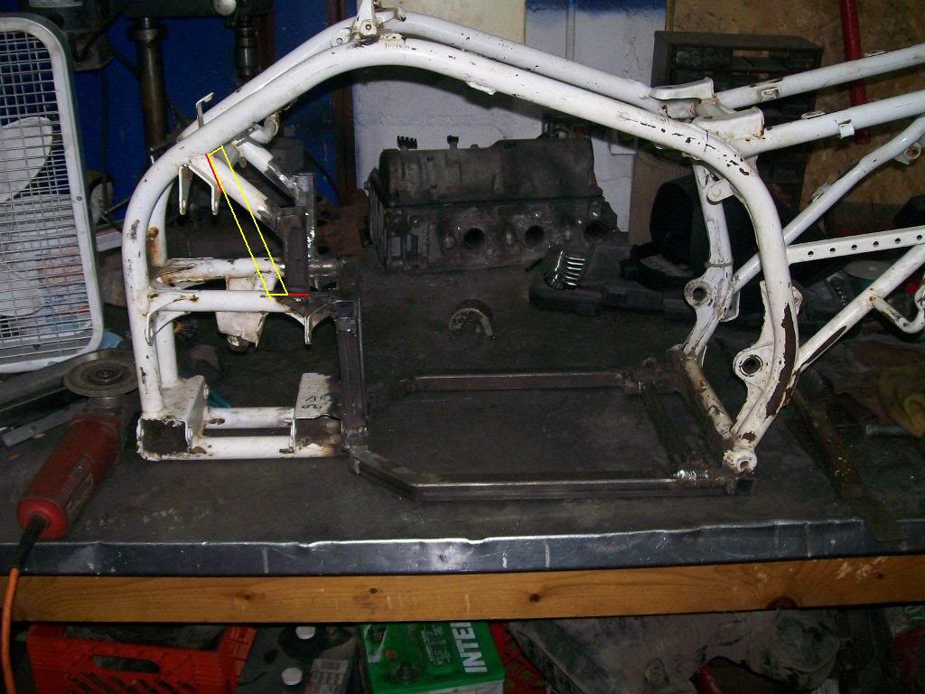

Really? This is my first time building a frame so I am worried about that kind of stuff. The tubes for the rear mounts were glowing red when I finished welding so I was pretty sure I got a good weld on them. I know the welds don't look super smooth, but I got a good sound when laying the beeds. What do you guys think?
I think drifz is talking about where the square corner is welded to the original part of the frame, not the motor mount piece. I don't think he's done with that area. The last picture set was with the motor mount beefed up but blocking the welded area from view. The first set of pictures shows the area very well but everything was only tack welded together...
I would chop that area of the frame out and run a piece of tubing from right behind the upper shock mount to right on top of the rear upper control arm mounting spots. I would then either trim the pipes and bend them tighter or purchase some stainless and extend the straight pieces and then curve the pipes down inside the frame between the lower control arms and then back towards the back of the quad. It'll make them difficult to remove but better flowing for balancing the pipe pulses. Anything you do to that pipe system is going to drop top HP numbers but the less you can do to it the better off you'll be. When you get the pipes down to two, you might want to make an H pipe to balance the two pipes before you enter the silencer. I'm not sure how much it's going to get some of that lost power back but it's a simple exhaust modification and it might help.
ooooh I see... right now its welded all the way across the back and front. I don't have any pics of that. The sides are just tacks until I find out how I want to do the pegs. There will also be a gusset plate that joins the rear round bar to the mid cross bar between the rear motor mounts.
Like this?
exactly like that. Your head has the exhaust ports aimed straight at the piece that sticks out the farthest right now. If the frame followed the yellow line instead of the crook there is now, you might have enough room to peacefully bring the center two exhaust pipes out without too much hacking or flow disturbance.

I really thought about what you said. I cut some test fit bars and after a few hours of looking at the frame again... I made a executive decision to mod the pipes. I did not have to takes wedges out like I thought I would. I just made 3 or so cuts with the cutting wheel and slowly curved/tacked the pipe. The bar we talked about cutting out was not in the way.. the upper rear a-arm mounts were... this pretty much forced me to just change the pipes a bit.
