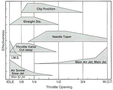

What does the jet needle do for idling?

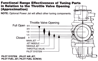

4.What does the jet needle do for idling?
I numbered them, in order:
1. It's gonna with a stock pilot! It's super lean at idle! Turning the lights on means jack sh*t!
2. You may be rich on the main, but not with the pilot or the needle!
3. NO!
4. Read belowVVVV
For Keihin carbs-
For Minkuni carbs-
