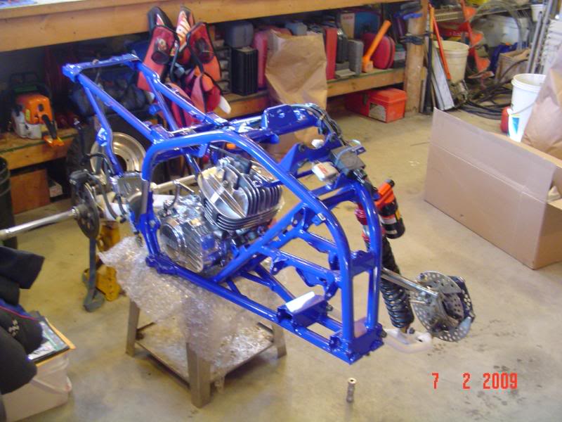

could sombody please post a pic on how the iring set up is supossed to go back on the bike? how is it routed through the frame? i dont think i have it right please help me
if you didnt untape the harness it should be the right routes.
Just start from the back,with the oil injector and tail light connectors,then wrok your way forward
Reactions: jostith
runs all up the left side. where the brakelight wires go back the coil wires split off and the rest follow the left upper frame rail through to the front of the frame where the boxes mount up and they are tied on the inner part of the fame to keep out of sight
i got all that right but when they feed into the part that holds the brake line in the front on i think thats were its messed up is it supposed to go under or over?
heres a pic of mine when I was putting it back together. Like 98blaster said, the main harnees goes up the left frame rail
