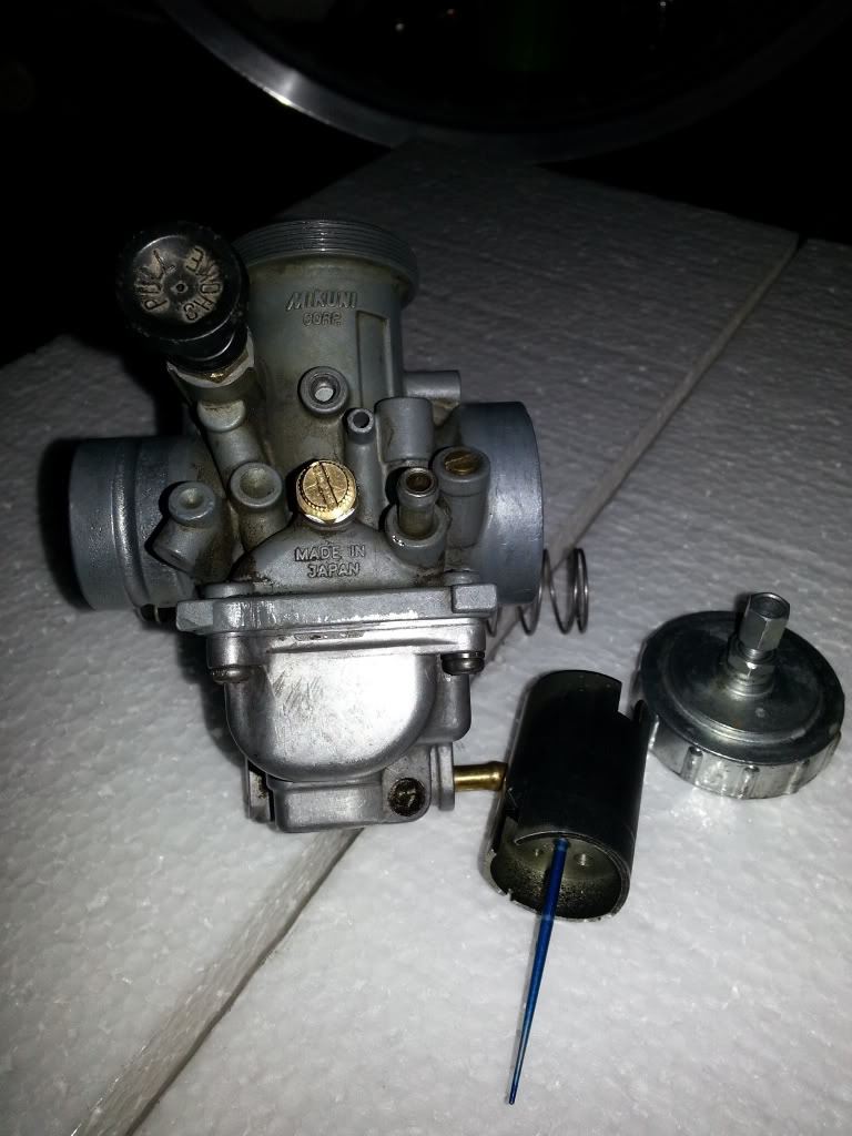

Needle in bottom slot, DMC is a thirsty beast down low.
I would add a #310 to the list you never can tell if the porting will change the flow.
Bottom right, the needle is the blue tapered appendage coming from the slide, yours may be gold or silver colour.

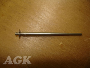

but until then, here's some pics.....

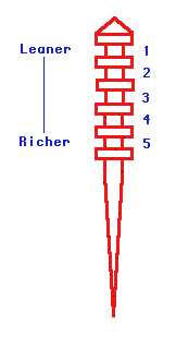

/\ the clip can be moved up/down the grooves to change the mid range jetting leaner/richer.
while holding your thumb on the clip to keep it from taking an inter-planetary flight across the room :eek:
push the open end of it down against a hard surface while gently rolling it so it pops off its groove.
reverse the process to reinstall it.
move the clip up to lean the circut, and down to richen it.
up lowers the needle taper into the needle jet allowing less fuel.
down raises the needle allowing more fuel.

so are you saying i need to put the clip on the bottom slot ?
yes, that is his experience with the DMC pipe.
but, he is at/near sea level ?
higher elevations will require leaner jetting....clip in a higher position.
starting at the lowest groove/richest setting is safe, then work the clip up the grooves 1 at a time until it pulls hard, or 1/2 throttle plug chops confirm it is jetted correctly

I'm at 1000-1100 feet above sealevel. As per Blaaster's recomendations, I did lower the clip for my Dmc pipe. I ended up only dropping it one spot and plug chopped at 1/2 and 3/4 throttle with a load on the motor.
He is right. It is a Very Thirsty in the low end, But an amazing pipe.
